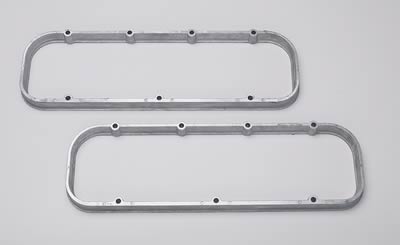

Would the 1.150" spacers that the speed shops sell help any? Found these on Summit.
Don't know if these are for Mark IV as i'm not up on my BBC models. There only $107. Seems high to me but better than $400 for a pair of covers. Sorry for only the pic but i couldn't link to the ad.
