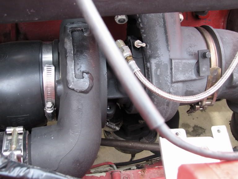

Guest 280ZForce Posted May 23, 2006 Share Posted May 23, 2006 you just bolt it on...no need to build a custom and very pricey manifold just for an ext w/g. and you dont need to build a manifold for 3 cylinders per section. My holset is ext. gated...the pics I posted above doesn't show it, but I had the manifold modified and had a w/g flange welded onto it. Your w/g flange can look differ than mine depending on the size of your w/g, but the only reasonable place for mine is as shown below. It's actually longer than it looks, it mounts right under the turbo. Turbo and w/g not mounted... Then w/ turbo and w/g mounted... Quote Link to comment Share on other sites More sharing options...

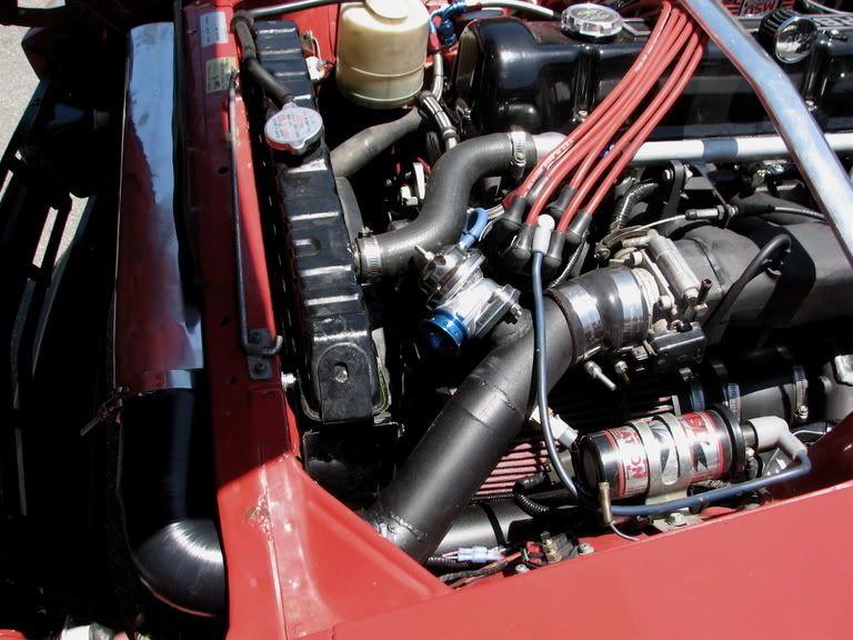

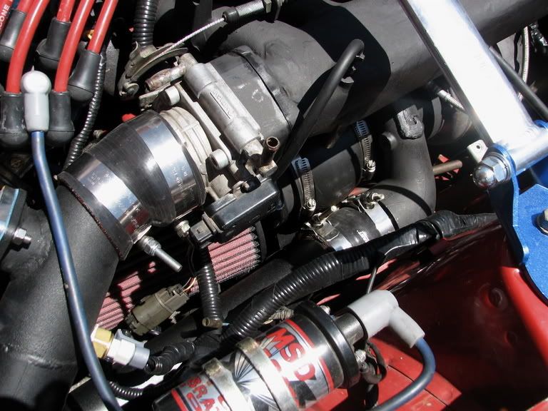

Guest 280ZForce Posted May 23, 2006 Share Posted May 23, 2006 Are you running home depot couplers all around or just on the intake piping? I can see one silicone or just a heavy duty reinforced coupler off the compressor housing. the coupler you see for the air intake is the only non-silicone one I am using because good luck finding a 4"-4" coupler for a hy/hx35, plus if you did, it would be ridiculousy expensive. I think your h1c has a smaller fitting so it shouldn't be hard to find a silicone coupler for you. the rest of intercooler piping all has Vibrant 4-ply silicone coupler. I am using a 2.75"-2.5" off the TB, then a 2.75"-2.5" off the turbo to the ic piping. then I have 3"-2.5" 90* couplers off the IC to the piping. Quote Link to comment Share on other sites More sharing options...

proxlamus© Posted May 25, 2006 Share Posted May 25, 2006 i'm running a HY35W ... 4" Aviation ducting.. used on turbocharged aircraft Next to the stocker T3 Quote Link to comment Share on other sites More sharing options...
