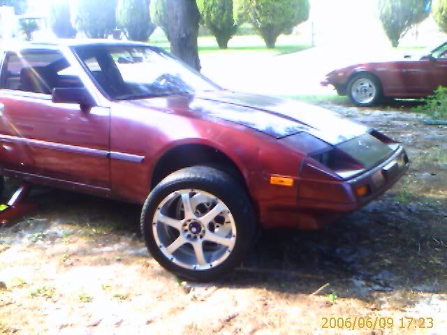

I bought 17x114.3 Enkei RS6's for my 86 z31. they are fine in the rear, besides needing the camber adjustments....but in the front they rub the strut. what spacers do I need, and where can I get them?

If these are 5 lug, Ross can have some made pretty quickly in the 5 lug pattern for you. I can't tell from the pics BTW.
