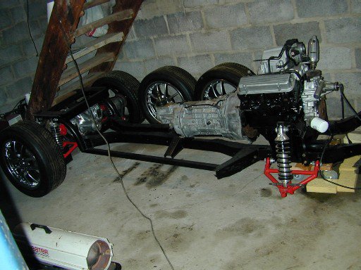

May be a little extreme but if you plan on turning up the wick on that "fully built" KA24, you want something that can hold up. Because of the Jag design, it is fairly easy to modify for the narrow Spit. This is a GT6 and should give you a great idea of what it would look like. I have more pics if want them.
Scottie,
Those pics look pretty sweet. Id be interested in more pictures and any build details! Also, who made that lower control arm in the front pic? Was this your car? With that t56 in there, the shifter must be almost behind the driver seat!
My only concern about the jag irs is the weight, but i do like the adaptability of it.
My built KA is expected to put out about 400-ish horsepower.

zlalomz, - yes, i'm well aware of the GRM build. They did a good job, and i may end up using something similar to their design. There was also a guy by the name of Ric Gibson who had a single turbo rotary putting in excesss of 400 hp to the wheels in his spit, but his site has strangely disappeared.
Email me with your address and I will send you what I have. Seems I have exceeded the limit on pics I can post on the forum. Anyone know how I can see all I have and clean them up?
Yes, the Jag IRS will add extra weight but in the right location and probably will cost you what, 10hp, over another beefier IRS? Those of you that have had to pull out and handle a Z IRS especially with the R200 know what I mean. I had to ship one :eek: With 400+hp its probably a nit.
It is not my car but belongs to someone on the Turbo buick board. Have not communicated with him in quite a while but sure I could track him down. Yes, that's a T56 behind a Turbo'd Buick.
