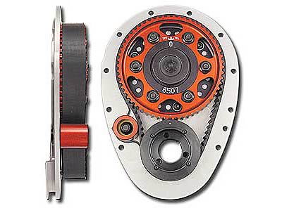

"how does it all compare to a belt drive?"
belt drives are generally far more expensive, at $470-$1000 vs $160-$500
they run quieter and have advantages
http://store.summitracing.com/partdetail.asp?part=CCA%2D6507&N=317828+115&autoview=sku
