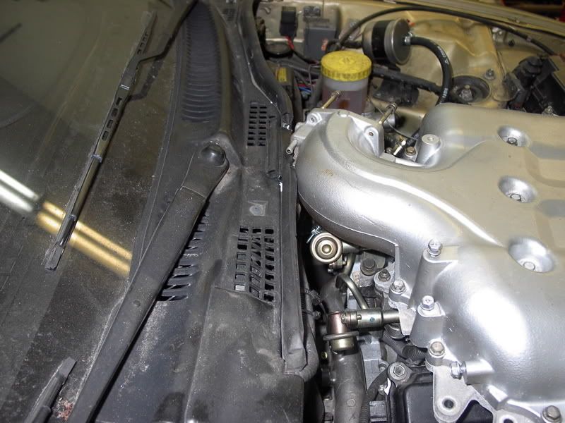

drews240 Posted November 5, 2008 Author Share Posted November 5, 2008 evildky said: about the hood clearance issue, why not do the old v8 s30 trick and space the crossmsmber from the chassis, this has been done for years on the hybrid z's, of course you can't take it too far but that extra 1/2 inch can make a huge difference Well the idea behind this swap kit is to keep the price down and have a solid swap. To refabricate completly a cross member is costly. With the hood cowl we chose it is not a drastic change and if you llok at the picture taken from the side you can see it does not stick out that much. Drew:icon14: Quote Link to comment Share on other sites More sharing options...

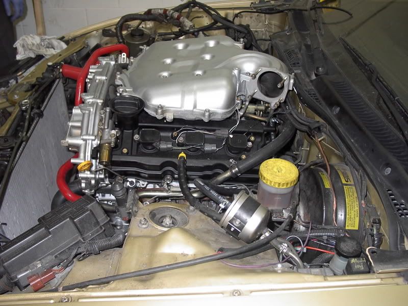

drews240 Posted December 6, 2008 Author Share Posted December 6, 2008 After doing 4 customer Z's with this set up mine is finally done. this is fire up before exhaust. Quote Link to comment Share on other sites More sharing options...
