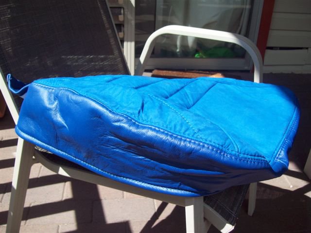

Boy from Oz Posted September 21, 2013 Share Posted September 21, 2013 I also have the seat trims. I didn't like the colour all that much when I first saw them in the GTOs (see photo #1) but the more I thought about it the more I got used to it. Unfortunate, as they will be the last item to be done on the project, I won't be in a position to fit them for some time. Quote Link to comment Share on other sites More sharing options...

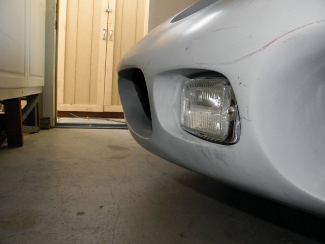

TomoHawk Posted October 14, 2013 Share Posted October 14, 2013 On 9/30/2013 at 7:00 AM, Tokyo Drftr said: The square lights? I have a set of KC lights that came with the kit. I can give you the part number Yes, My kit had no lamps, so I need everything. I'm referring to the two clear rectangular driving lamps on the nose. I'd appreciate the information, and if you can a little description of how they were installed. Quote Link to comment Share on other sites More sharing options...

Fauxre Posted October 16, 2013 Share Posted October 16, 2013 On 10/14/2013 at 2:13 AM, TomoHawk said: Yes, My kit had no lamps, so I need everything. I'm referring to the two clear rectangular driving lamps on the nose. I'd appreciate the information, and if you can a little description of how they were installed. These are what I used. http://www.oreillyauto.com/site/c/detail/BLZ0/DF1073KB/N0393.oap?ck=Search_N0393_-1_-1&pt=N0393&ppt=C0335 Not a perfect fit, but I don't mind the chrome bezel sticking out a little bit. Installation was pretty simple. I drilled a hole in the center of the molded mounting bucket for the wiring, then using just the lamp and front bezel as a template I drilled the two holes for the mounting screws. Secured it all with a couple lock nuts. To make it all fit snug, I cut a couple of gaskets from a sheet of cork to go between the bulb and fiberglass. Quote Link to comment Share on other sites More sharing options...
TomoHawk Posted October 22, 2013 Share Posted October 22, 2013 (edited) Thanks for the information. I have a set of 55W driving lamp now, and they don't really help. IMO, you need at least 100 watts. Edited October 22, 2013 by TomoHawk Quote Link to comment Share on other sites More sharing options...
