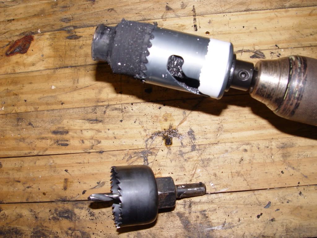

Step 2: Using the 1 1/2" Hole saw drill out the metal sleeve from both sides. It will come out as a chunk. Remove it from the bit and switch to the 1 3/4" bit.

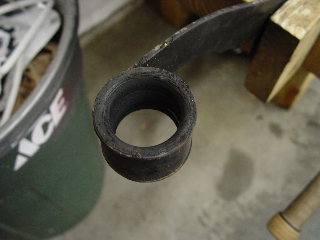

Step 3: Drill out as much of the remaining bushing as you can with the 1 3/4" bit. You'll be left with this:

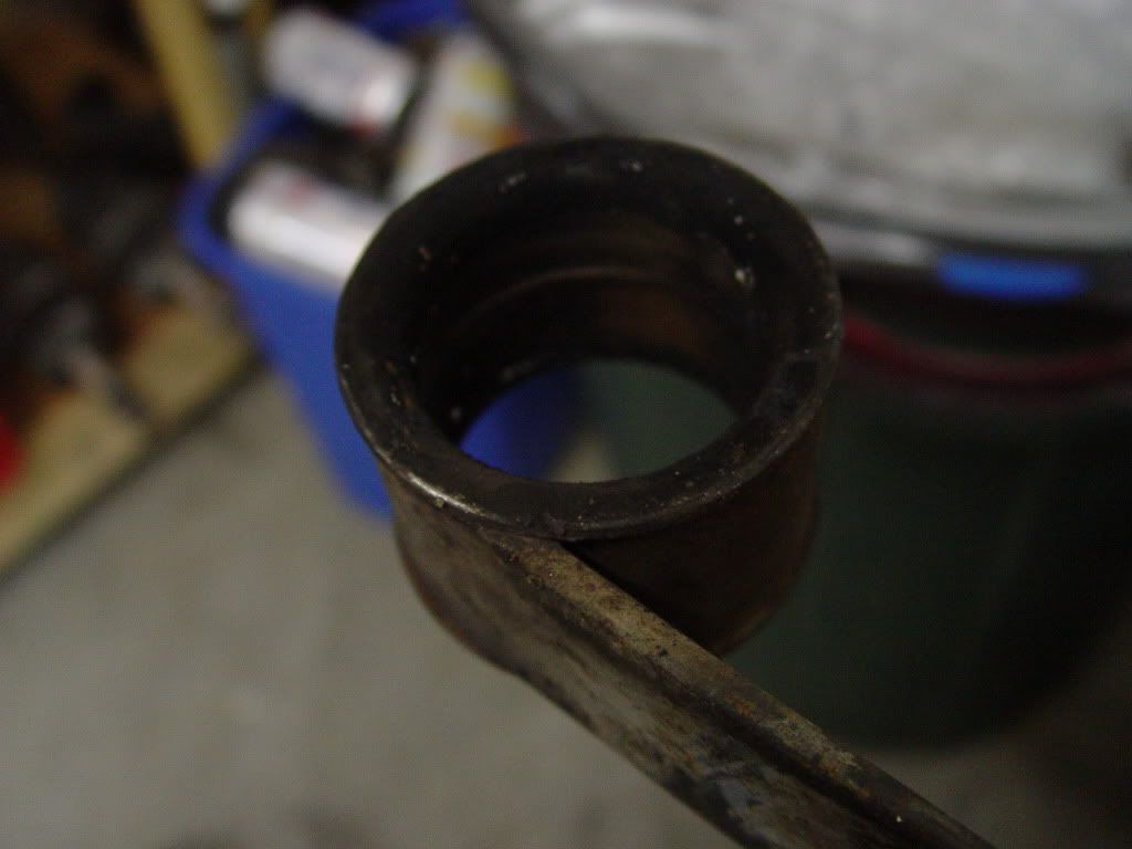

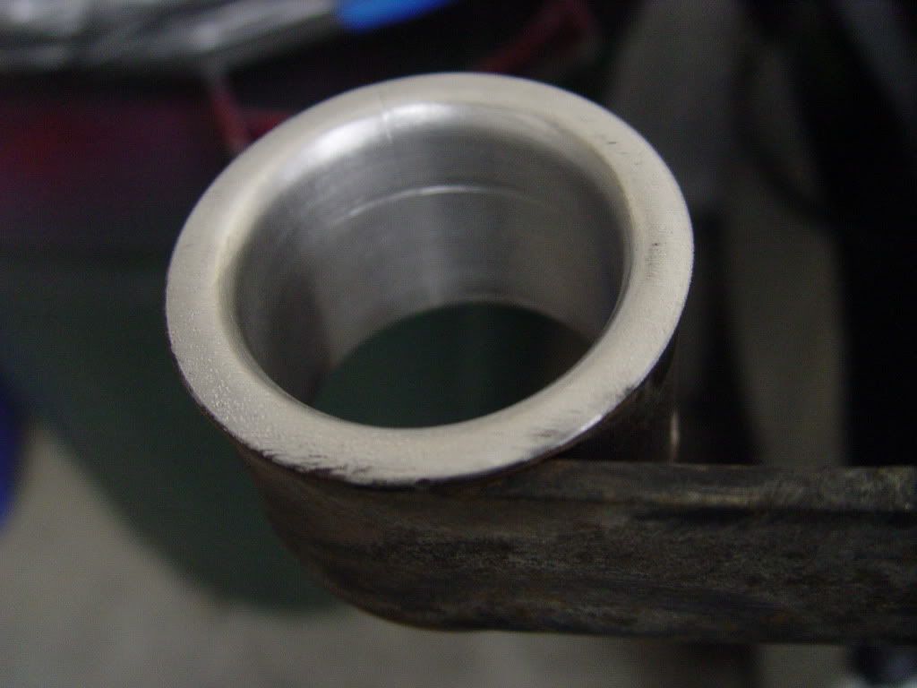

Step 4: GO OUTSIDE!!!! Put the bar somewhere that you won't catch more stuff on fire and blast the remaining rubber bushings with the torch until they're cherry red. Let the bar cool and bring it back to the vice. It will now look like this:

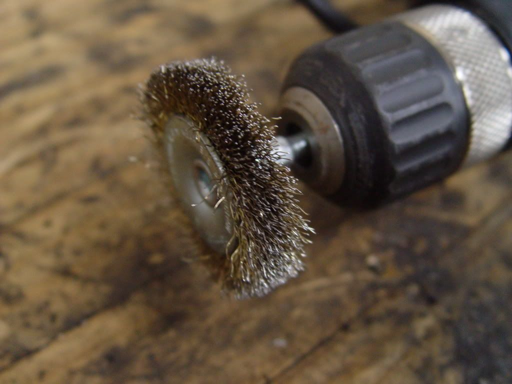

Step 5: Chuck the little wire wheel into an electric drill, don't punish your cordless drill with this job.
The burnt rubber will easily brush cleanly away from the metal, put a trash can under where you're working for easy clean up. Ta da!
