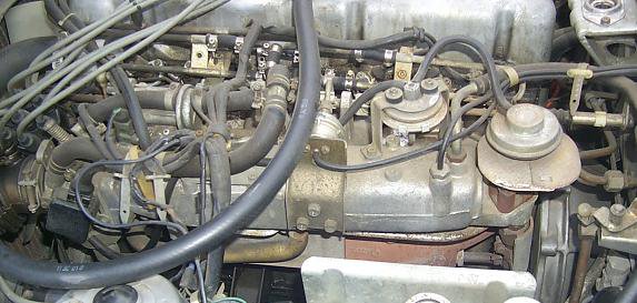

SuperPickle Posted December 21, 2006 Share Posted December 21, 2006 Yes, I've searched, but I guess the knowledge is so well known that it's just assumed everyone knows where it is. I know that it's on the exhaust manifold, but where? There are a few 'doo-hickies' that it could be hidden inside, but I need it for a trip tonight, so I can't just start ripping things apart. PLEASE spell it out for me, as I'm a n00b. Quote Link to comment Share on other sites More sharing options...
naviathan Posted December 21, 2006 Share Posted December 21, 2006 Need info...What year? Quote Link to comment Share on other sites More sharing options...
SuperPickle Posted December 21, 2006 Author Share Posted December 21, 2006 It's a 1977 280z california model (basically, just more emissions stuff) Quote Link to comment Share on other sites More sharing options...
naviathan Posted December 21, 2006 Share Posted December 21, 2006 The O2 should be pretty obvious. It's on the drivers side in the exhaust manifold right after where all the exhaust runners meet. I have a 77, although not a cali model it does still have an O2...I think. it's currently in monster reconstruction stage. Quote Link to comment Share on other sites More sharing options...
SuperPickle Posted December 21, 2006 Author Share Posted December 21, 2006 That's really wierd, because I've been staring at it for helf of the day, and I can't see it. I'll go look again right after I post this, and I'll try to get a picture of the area too, just in case it's like looking for the 'remote control'. Quote Link to comment Share on other sites More sharing options...
naviathan Posted December 21, 2006 Share Posted December 21, 2006 I know I hate that. Looking for the remote and it's right in front of you. It will look like a small cylinder that steps down in size then has a single wire coming out of it. Quote Link to comment Share on other sites More sharing options...
SuperPickle Posted December 21, 2006 Author Share Posted December 21, 2006 here's a close-up Quote Link to comment Share on other sites More sharing options...
SuperPickle Posted December 21, 2006 Author Share Posted December 21, 2006 ...and a not-so-close-up Quote Link to comment Share on other sites More sharing options...
sweetleaf Posted December 21, 2006 Share Posted December 21, 2006 it's not even in the picture. That is your intake manifold. The EGR is right on the upper right corner. Look down below your intake at the exhaust manifold and you should see it. Cylinder looking with 1 wire comming out. Quote Link to comment Share on other sites More sharing options...
SuperPickle Posted December 21, 2006 Author Share Posted December 21, 2006 could someone please take a picture and point to the thing? I'm sorry if I sound frustrated, it's just that my car insurance runs out at midnight, and I'm literally just waiting to get on the road to Boston. I looked again, sweetleaf, I even felt around, but I don't know what the hell I'm looking at with this car yet. Quote Link to comment Share on other sites More sharing options...
mario_82_ZXT Posted December 21, 2006 Share Posted December 21, 2006 Wasn't there no O2 till like 79? Or was it 80? My 78 280z doesn't have an O2 sensor... Mario Quote Link to comment Share on other sites More sharing options...
sweetleaf Posted December 21, 2006 Share Posted December 21, 2006 Mario could be right, I can't remember what year the cali spec cars got their 02's .. If you can get a pic of your actall exhaust manifold we could tell you for sure. Also, why do you need to locate the O2 ??? Quote Link to comment Share on other sites More sharing options...
Administrators BRAAP Posted December 22, 2006 Administrators Share Posted December 22, 2006 Just curious, why do you think you need to find this supposed O2 sensor? If your Z is a stock ‘77 car, it does NOT have an o2 and never did, unless someone installed an aftermarket EFI with O2 sensor or late model OE EFI system, (not likely). . Hmmm.. I get the impression your car has an issue, and you may have mentioned said issue to someone at work/friend and they in turn told you it was your O2 sensor, so now you are on the o2 search? Am I right? You are amongst some of the most knowledgeable OE EFI L-6 people in the country. Just give us the “details†of what is going on, when, and under what conditions and most likely we can help you diagnose the fault. Quote Link to comment Share on other sites More sharing options...
