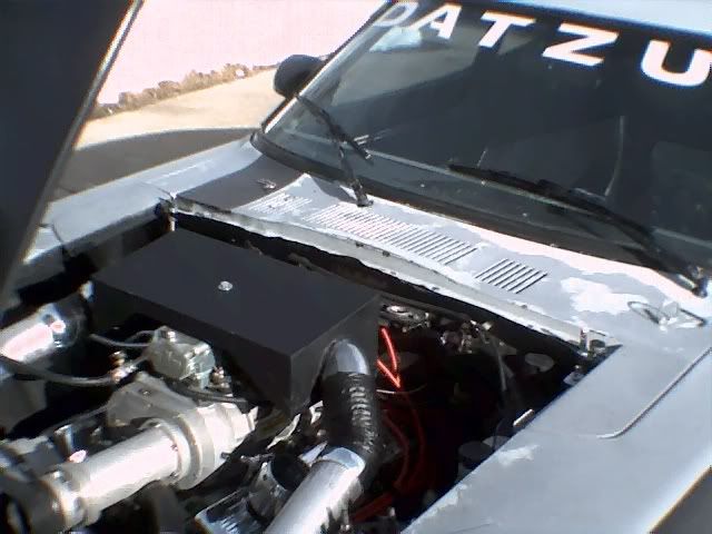

Not sure if i have enough air flow or if what i have done works properly .
Take a SBC 350 weiand super charger 144 series a demone 750 cfm blower carb and put a box on top of the carb flange that is 1 3/4 inches tall above the flange and covers the flange aera itself .
Then extends to each side of the car and kinda angles down a bit to fit a 3 inch intake tube on each side .
The air filters are not the question but my intake box wondering if its to short but i cant make it taller as it wont clear the hood . Ill try to post a pic if i can figure out how to get it on this thread

You are going to need a little more space on top of the carb in my opinion. You should shoot for at least 2" above the top of the opening of the carb. looks like that will be a fun ride, just watch your fueling and you will be fine.
