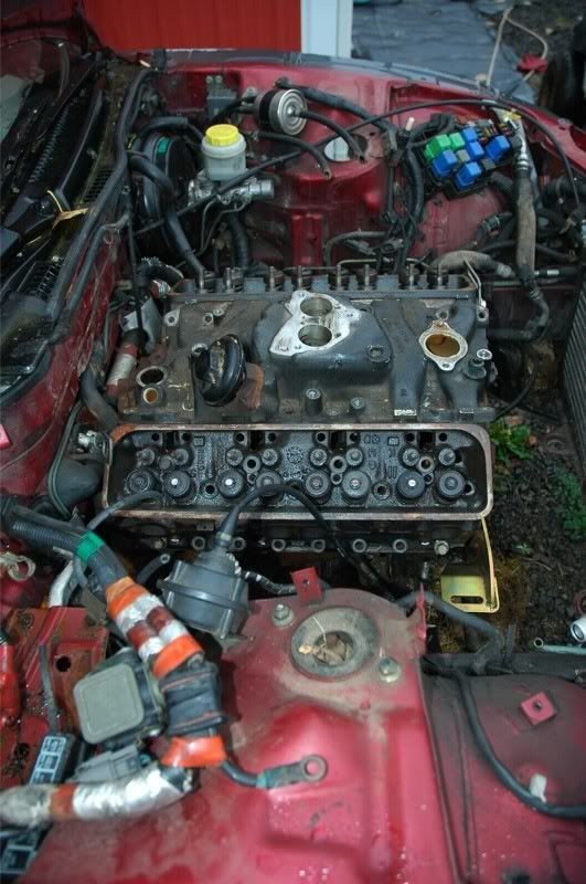

Administrators BRAAP Posted November 6, 2008 Administrators Share Posted November 6, 2008 why does the gauge cluster have to go? couldnt it be wired custom? and couldnt a custom shaped shifter be made to come out the right location? A dog leg shifter just might work. Looked in that myself while mocking up the SBC T-56 Z-32 project. Dropped that project in favor of the VH45DE conversion bolted up the Z-32 5 speed, i.e. no cutting the firewall and I need a home for the VH45DE out of my ’96 Q-45 donor car. Here is pic of a SBC sitting in the engine bay of my Z-32 V-8 mock up mule. With bell housing lined up flush to the firewall, (oil pan sitting ON the rack, crank centerline is approx 1 ½” higher than then VG30DE), firewall HAS to be cut to get the bell housing to fit, and the T-56 shifter is 2” forward of the stock location. Not sure if the LSx T-56 shifter to bell housing dimensions are much if any different. Ron Tyler built a dog leg shifter for a T-56 shifter relocate a while back, (that shifter is somewhere in the shop currently), If memory serves, it was a 4” offset. Quote Link to comment Share on other sites More sharing options...
