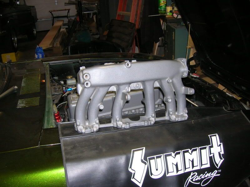

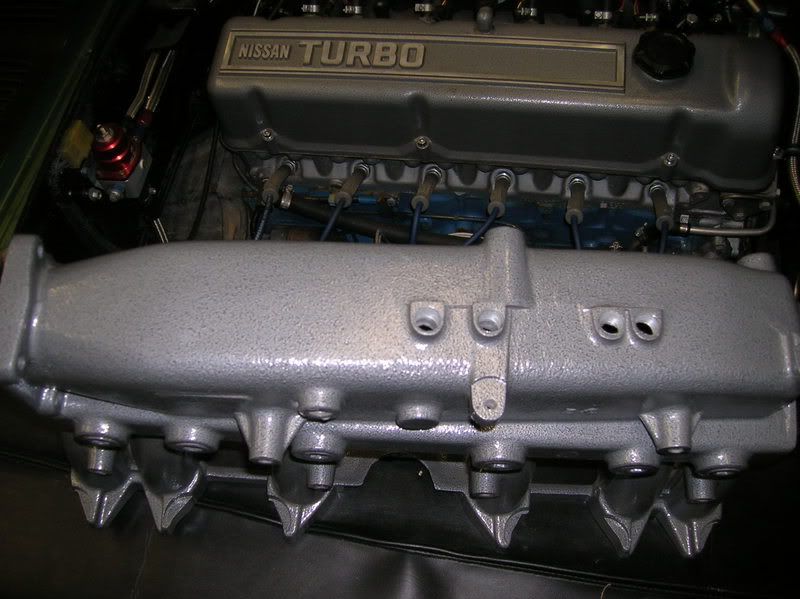

Roostmonkey Posted January 27, 2007 Share Posted January 27, 2007 I shaved most the openings off the top of this manifold and tig welded it up.ThenI drilled/tapped some of the mounting holes on the side of the manifold for vacuum ports/boost guage ect... This keeps the top clean and uncluttered. Then it was powdercoated with a hammered siver finish. If you dont have a nice clean nonporous weld, youll get some outgassing during the PC and will leave blemishes in the paint. Quote Link to comment Share on other sites More sharing options...
