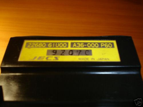

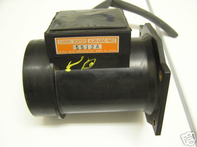

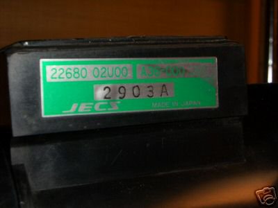

Hi, I'v been searching for a good MAF for my RB25DET for a while and noticed this...
The RB25 uses the same MAF as the V6 Maximas so, you can avoid the "Drift, Initial D" tax and get a MAF for way cheaper.
Here's a list to help find the right part. The first series of # is always 22680 for the Nissan MAFs, the other #s and the color of the tag changes.
Produced by JECS Japan.
1: Q45: (90mm), {Yellow tag}, /#:22680-61U00-A36-000-[P60]

9: RB20, 25, DE, DET Series2, (75mm), {Green tag}, /# 22680-02U00-A36-000-[J60]

4: J30, 90-96 Z32: 75mm, {Orange tag}, /# 22680-30P00-A36-000-[N62]

The 75mm units seems to be all the same, they are just wired differently.
Please correct me if I'm wrong.
Hope it can help.

J30 - part # 22680-30P00 - 75mm
300ZX and 300zx TT 90-96 - part # 22680-30P00 - 75mm

RB20DE(T) - Part # 22680-02U00
RB25DE - Part # 22680-02U00
VH45DE - Part # 22680-61U00
VH45DE - Part # 22680-61U01
