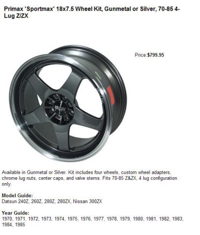

zfever Posted February 13, 2007 Share Posted February 13, 2007 Hi guys, Newbie at this, (i just got excited when i read "welcome to our newest member zfever") ne way, ill get to the point... iv got myself a 71 240z and im looking for some "nice" wheels. so far ive read that 16 inch and 15 inch wheels do best. But i was looking at these 18 x 7.5 wheels... Im not sure if im makin a mistake.. any suggestions/comments? they are Primax sport max gunmetal Quote Link to comment Share on other sites More sharing options...

Bartman Posted February 13, 2007 Share Posted February 13, 2007 Did you contact the seller? From the verbiage in the pic you attached it states that it comes with wheel adapters and fits 70-85 Z&ZX. Look at this thread if you haven't already: http://forums.hybridz.org/showthread.php?t=118865 There's a group buy going on for 16x8 Sportmax wheels. Quote Link to comment Share on other sites More sharing options...
pete280z Posted February 13, 2007 Share Posted February 13, 2007 It looks like these are from the MSA catalog and are using an adaptor to fit. So this is a high offset 4x114.3 or 4x100 wheel. If you're OK with using an adaptor to fit FWD style wheels, check out Ross's (modern motorsports) Honda adaptors. There are tons of options for Honda pattern/offset wheels. Quote Link to comment Share on other sites More sharing options...
toki Posted February 13, 2007 Share Posted February 13, 2007 just google "sport max 962"...they come is better sizes, and they are about $600 for a set...they are also heavy as sin. Quote Link to comment Share on other sites More sharing options...
