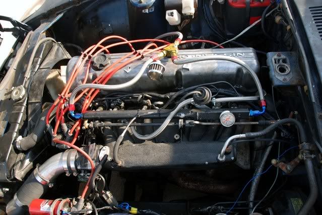

veritech-z Posted March 14, 2007 Share Posted March 14, 2007 What are your reasons? As long as you have inlet outlet and the regulator you should be fine. Some people even do away with the return line but I personaly wouldn't do it. Does your regulator still work without a return line? Unless you get one of those restrictor deals that just pinch the line to lower the pressure, I don't see how it could...I assume he want's to clean up his engine bay, that's the only reason I can think of to do it. The easiest (albeit not necessarily the cheapest) way is to get an aftermarket rail, or go to some place like http://www.rossmachineracing.com/index.htm and make your own from some universal rail sections. I got mine from Ebay bundled with the throttle body spacer to use a KA throttle body for around $100 or so, it's been awhile. Wonderllama, here is a current picture of my engine in running condition (I even cleaned my plug wires for ya): Quote Link to comment Share on other sites More sharing options...
LineC Posted March 14, 2007 Share Posted March 14, 2007 Is that Krylon black? What is the crazy tee on the valve cover? Is the pressure line splitting for the inlet and outlet through that T??? Quote Link to comment Share on other sites More sharing options...
veritech-z Posted March 14, 2007 Share Posted March 14, 2007 That's actually wrinkle finish black, and the braided lines have rubbed some of it away a bit since I've been fooling with my injectors so much recently. The Y fitting up there was originally a low restriction solution to get fuel into both my SUs that I was running, and since this fuel rail had a provision for several 1/8NPT fittings in addition to the 6 injectors, I decided to keep it and put the pressure gauge in one hole, and use the hole that used to be for the cold start injector to be the FPR feed line. I had heard a theory that feeding a fuel rail from both sides is supposed to give you more consistent feed to all your injectors...I can't say really if that's true, but it looks cool and it definitely doesn't hamper my fuel flow that I can tell. Quote Link to comment Share on other sites More sharing options...
