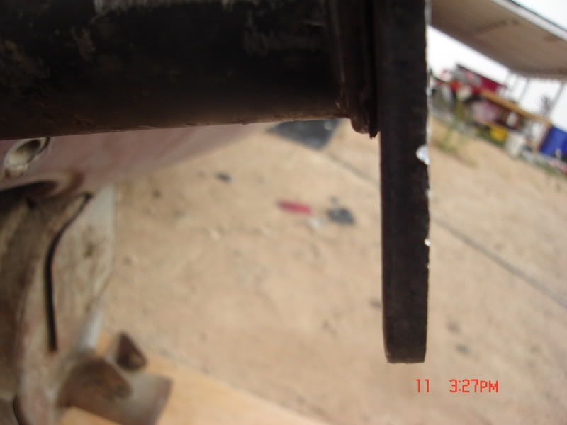

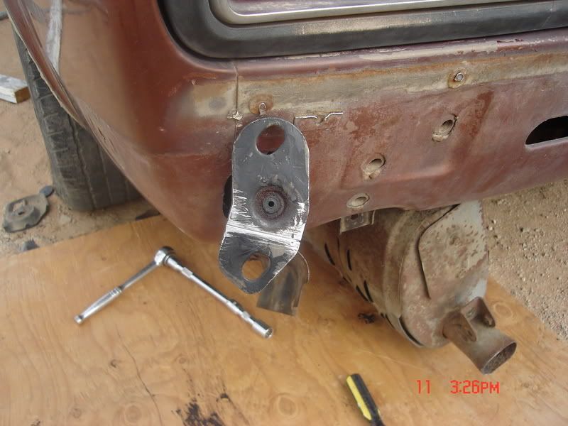

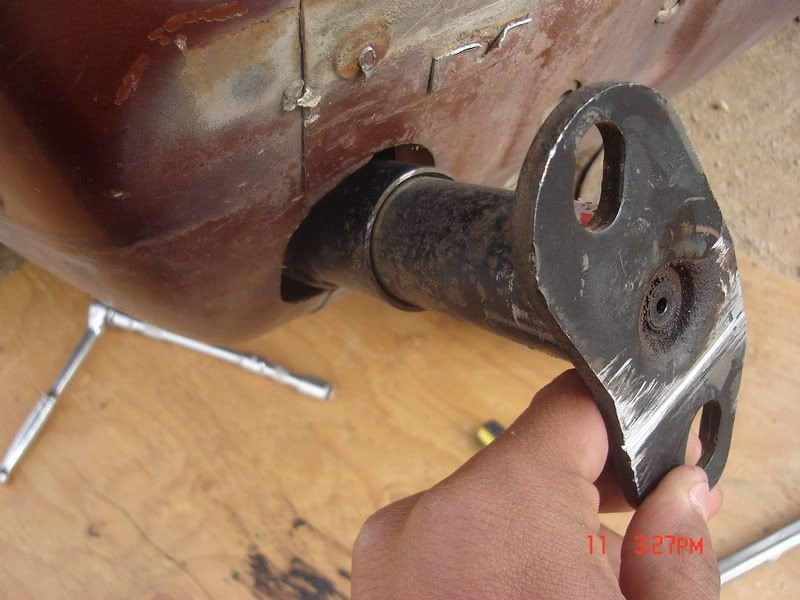

CalifaThugz Posted April 11, 2007 Author Share Posted April 11, 2007 Oh, and by the way 280zx_sliding it was where you told me. After I took the third one out It just simply fell down but when I couldn't find a way to simply slide it out... The hole is too small for the support to slide out. After that wouldn't work I tried to to saw it a little bit but I messed up 3 saws. Anybody know a different to slide it out? I don't have an electric saw to chop it so I'm stuck here. Three saw later after I kept trying I only got this far on the metal. I've also read a post around here somewhere and to cover up that its good to use J.B. Weld? I added this for no reason at all... I like my car! Quote Link to comment Share on other sites More sharing options...

mario_82_ZXT Posted April 12, 2007 Share Posted April 12, 2007 You'e cutting in the wrong place. I cut through the tube and cut the flange right off. A sawzall makes quick work of this. Though there must be a way to take them out without destroying them considering they are in there... Mario Quote Link to comment Share on other sites More sharing options...
