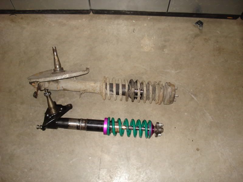

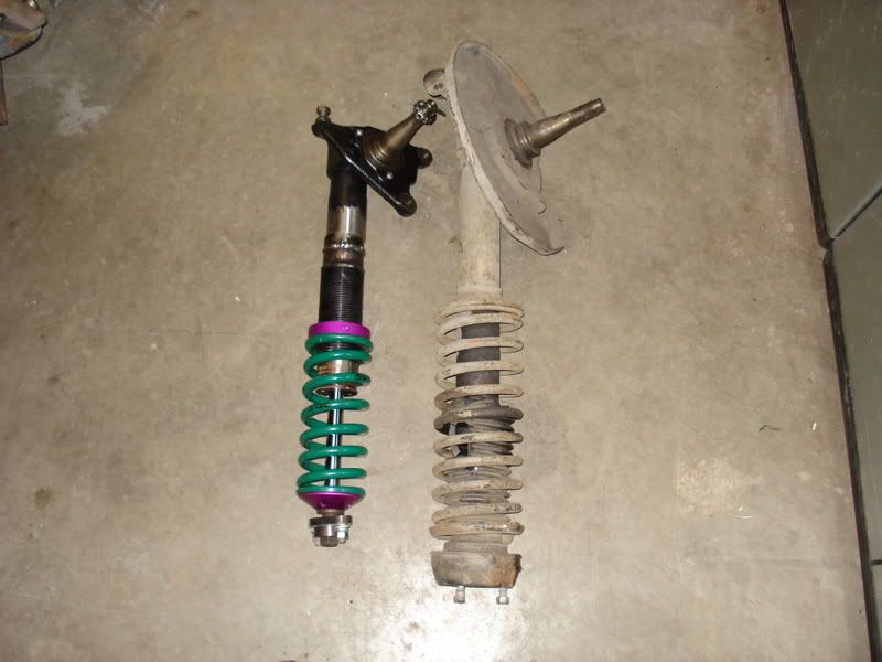

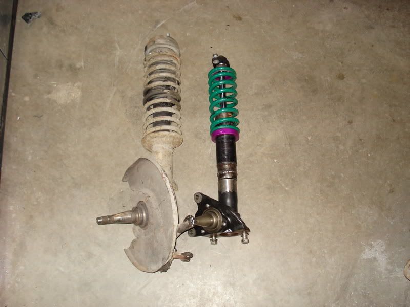

Well these are about as short i think you can go. I'm sure there are others out there but this should get my ride hieght were i need it and also have some travel in the suspension.
The stock struts you see are fully charged. the coilovers are just hand tight so they will compress somewhat. Any comments/opinion/suggestions before i get the strut housings welded up???

The struts have been section twice so not sure how much total out of a stock Z strut but its close to 3 inches.
I will get some pics of the car hopefully in the next few days and post them up. Its sitting pretty low now and i still have 4 inches or so of travel. I will have to install a bump stop. Overall really have with its stance and should perform really well at the track once i get the revalved inserts i need.

BTW if some of you didn’t catch it.... the spindles I sectioned into my struts are z31. These spindles accommodate z32 calipers by just bolting them on. You will need to be able to adjust caster as the caster is different on the z31 vs. the s30 chassis. I was able to tune it out to stock specs with AZC front control arms.
