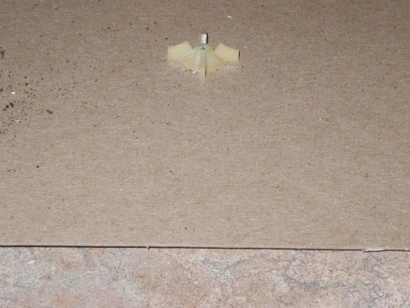

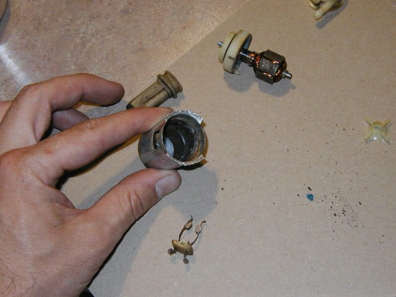

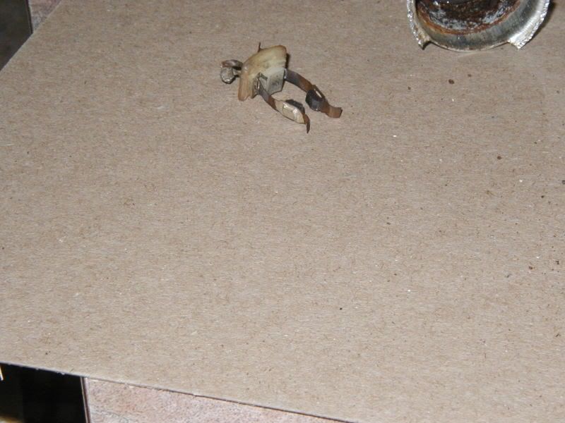

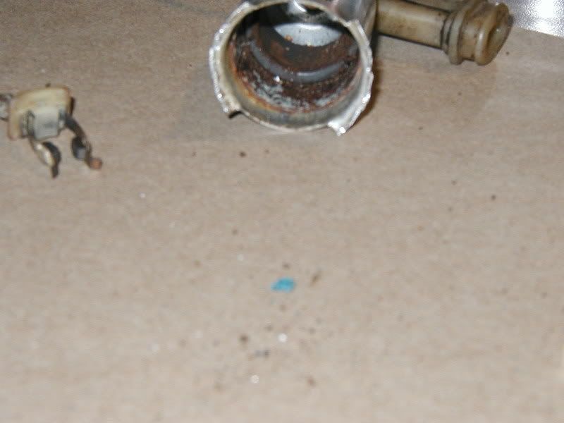

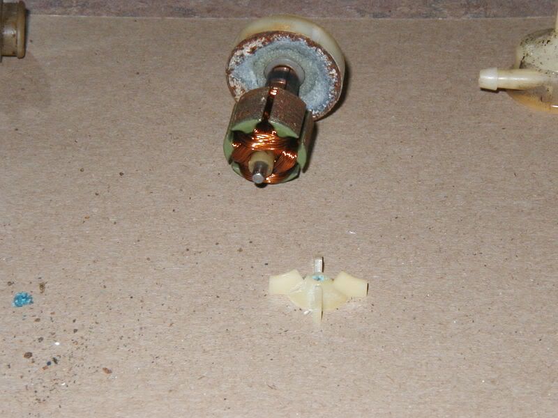

Wedge Posted May 14, 2007 Author Share Posted May 14, 2007 I took pictures i dismantled my washer motor and it all came in peices no frog hair wires lol but Im gonna try to derust it and try to make it work again ill make a DIY if it all works in the end . The propeler The rusted coil The rusted casing with bend tabs The connector peice All the parts Quote Link to comment Share on other sites More sharing options...
