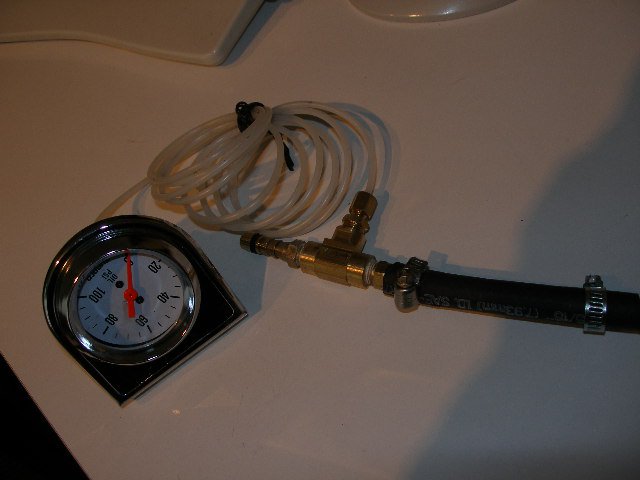

  22. you need to get an actual fuel pressure reading not "i heard the pump run". somewhere in the low 30's pic is a low cost pressure check you can make with parts from hardware store and a cheap oil pressure gage. goes between filter and fuel ring. is the fuel return coming from the fpr or did you run it direct to your container. no fpr low fuel pressure on ring lo press she no workee. use some deoxit by caig to clean the ecu, afm and tps electric connectors. if battery is weak or cables corroded z's don't like low voltage and all sort of electric gremlins as electronics don't work correctly. load test battery new cables.
