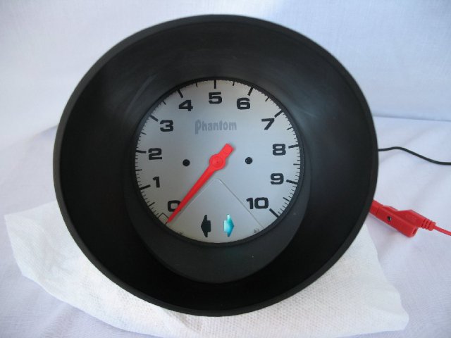

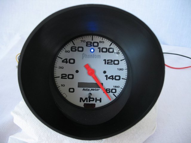

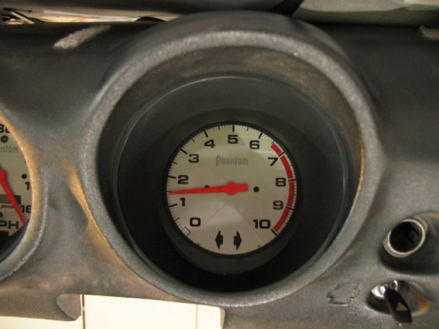

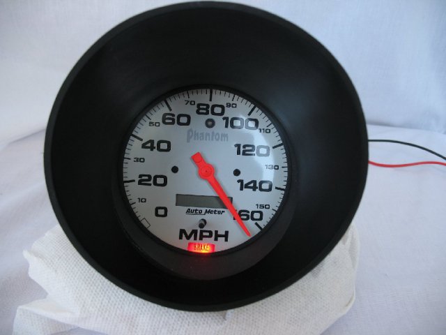

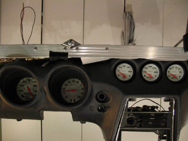

Guest daveoh Posted June 6, 2007 Share Posted June 6, 2007 Hi Guys, I looked though a lot of the posts last night and didn't find quite what I was looking for, but I think it helped me reach the right answer. Now I'm looking for confirmation on my reasoning. I butchered my autometer gauges (shown, if the upload works) and now have LEDs for the turn signals. I figured not having the same load (5 ohm) bulb would make the flasher inoperable, but after reading the posts I realized that there must be some load in the flasher, and furthermore, that the turn signal indicator bulb load relative to the load of the front and rear exterior indicators is probably trivial. I've now convinced myself that I don't have to do any further parallel loading of the LED and I'll still have a blinking signal, albiet at a slightly different rate. My question - Am I right or wrong? Will my blinkers still blink? Thanks, David O. Quote Link to comment Share on other sites More sharing options...
Dragonfly Posted June 6, 2007 Share Posted June 6, 2007 should still work... mine do. Dragonfly Quote Link to comment Share on other sites More sharing options...
mario_82_ZXT Posted June 7, 2007 Share Posted June 7, 2007 If they don't just get a (I believe it's called) solid state flasher unit. Those will work irregardless of load. Mario Quote Link to comment Share on other sites More sharing options...
e_racer1999 Posted June 7, 2007 Share Posted June 7, 2007 that's a NICE job.... Quote Link to comment Share on other sites More sharing options...
