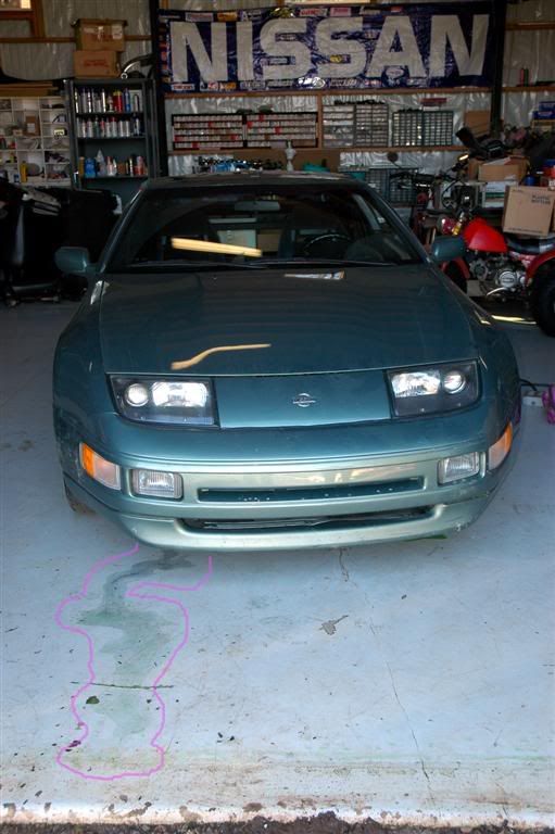

Then it came to me, with a one piece front end like Ricks, would it be possible to use the Z-32 head lights, or the Z-31 semi pop ups? If not the exact set up, maybe a derivative that would fit the YZ lines?…
Of course it would be possible. This is HybridZ, where we make anything fit anywhere. That would be nice looking, in addition to offering an inexpensive (If you don't assign an expense to your labor :mrgreen:) upgrade to lighting performance. In the end, I just decided that I wanted to keep one of the most distinctive features of the S30 styling, while developing my car's overall persona - kind of like a pumped up mutation of the Z.
