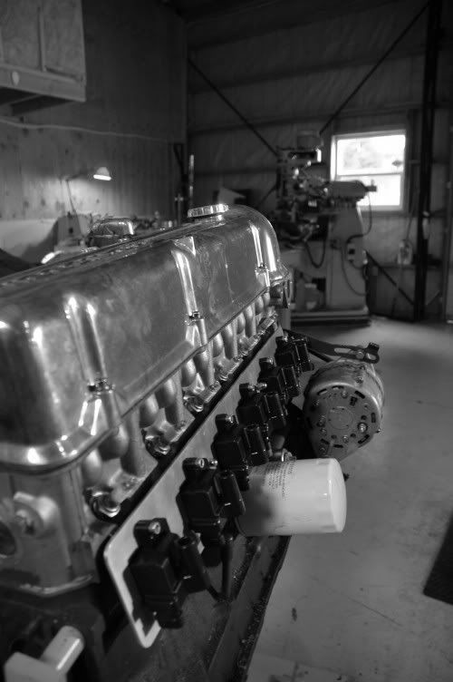

thank you matt,
i have injecters out of o lincoln towncar, and was in the process of pulling a 36-1 wheel and vr sensor out of a ford taurus but i diddnt have a puller, so i left it for someone else.
