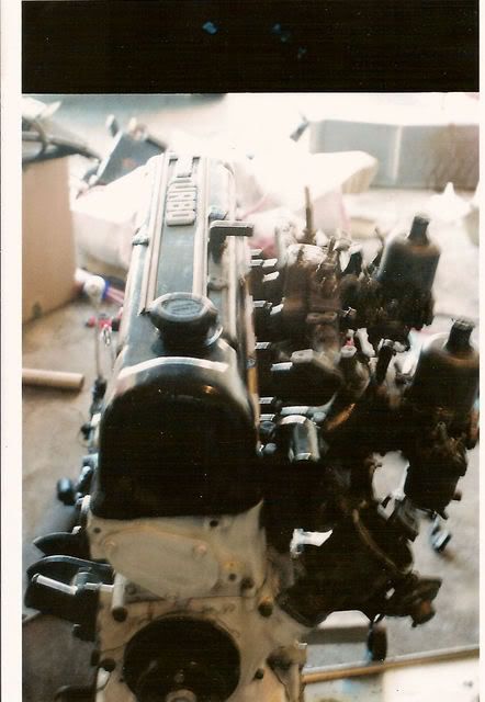

veritech-z Posted July 21, 2007 Share Posted July 21, 2007 Hmmm, thought I had a picture of my car with SUs on it in running condition, but all I could find was this pic of the engine on a stand outside of the car... The choke stuff should have come with the carbs, if not, you may be able to rig one up with a universal choke cable. I've never done it, so I don't feel confident trying to talk you through it. as for the T fitting, look closely at this pic of my engine fuel injected, and imagine that instead of a fuel rai, those two braided lines went straight into the fuel bowls of the SUs: I actually ran that exact setup, but instead of the AN fittings I just had hose clamps on the carb fittings. You don't need braided AN line, you can just get 5/16" fuel line (I think that's the right size, it's been awhile...) Keep in mind you do NOT want a "T-valve", what you want is a "T-fitting". If you go shopping for a valve, you won't get what you need. You are just trying to split a single line into two lines, you don't need the capability of closing one off. Quote Link to comment Share on other sites More sharing options...
