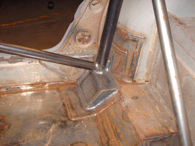

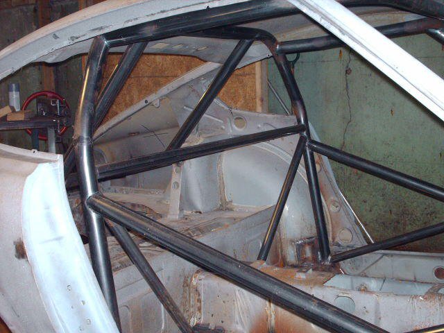

Well, haven't been working on the track z, but did find this little gem tonight
The main hoop has a 1/4" gap between the floor plate and is only welded 3/4 of the way around.
I just purchased a set of dimple dies to gusset in the cage to chassis. Looks like I'll have to look over all the welds.
