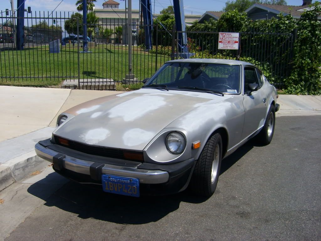

260Z Guy Posted August 2, 2007 Share Posted August 2, 2007 Hi All, I recently purchase a 260Z, and now I would like to do some performance upgrades to it . I have been looking at an l28 and 5-spd trans swap which looks like the simplest of the options. Although I found an '86 300zx turbo car in my area for fairly cheap. From what I have found out so far, I will need to make custom motor mounts and do some wiring. Has anybody done this before? If so, what was your experience? If I were to go with the l28 my plan is this: rebuild the engine, lower the compression ratio, and build a custom twin-screw supercharger kit (probably run 6-8psi). I have not calculated how much power that would put out yet, but I figure that since the turbo zx came from the factory with 6.8 psi on the turbo, then this setup should not put too much stress on the engine. This should satisfy my hunger for more power....at least for now Please let me know what you guys think. I would like to pick up one of the setups within the next week, so please let me know what you think and what your experiences have been. Here is a partial picture(I think photobucket cut it off b/c high resolution: Quote Link to comment Share on other sites More sharing options...
