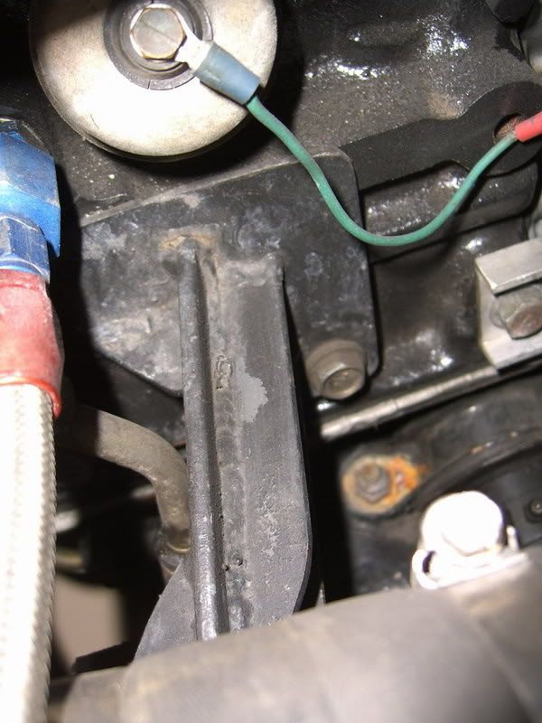

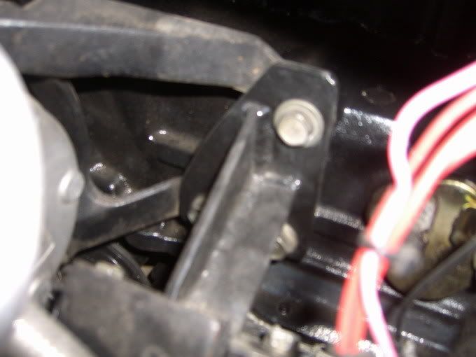

badjuju Posted February 11, 2008 Share Posted February 11, 2008 Do you mind if I post the pics here? Are the brackets 1/4"? Quote Link to comment Share on other sites More sharing options...
Clifton Posted February 11, 2008 Share Posted February 11, 2008 Do you mind if I post the pics here? Are the brackets 1/4"? No, go ahead, It was just faster to send them to you. The plate on the stock rubber motor mount is 1/8" everything else is 3/16". It could have all been 1/8" though. I wish I could get a better pic but there isn't any room. Quote Link to comment Share on other sites More sharing options...
