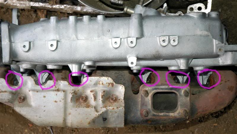

Administrators BRAAP Posted September 13, 2007 Administrators Share Posted September 13, 2007 After you get the upper intake bolts removed, you need to “loosen†(or remove), these 6 bolts under the manifold, then with some finagling and depending on how “attached/stuck†the manifold is to the gasket, it will come free. You will want to remove any heat shield that is attached to the underside of the intake manifold first. This applies to all L-6 engines and combinations whether it is a 240, 260 or 280 Z or ZX, carbureted, fuel injected, N/A or Turbo. Quote Link to comment Share on other sites More sharing options...
cygnusx1 Posted September 13, 2007 Share Posted September 13, 2007 I did it twice within the past three weeks. I leave the intake manifold shield on there. Some shields might be in the way, mine isn't. It takes about 1/2 hour to remove the intake and exhaust manifold once you have done it a few times. Of course I know all my bolts are in good shape so I'm not fighting anything. Those bolts that BRAAP circled are pretty easy to get to even though you cant see them. Use a 12mm long socket with three or four extensions, put a universal joint at the socket. Wrap the whole setup with tape to keep the u-joint rigid, and keep the stack from falling apart when you pull it back out. Loosen the 12mm bolts then remove the 14mm upper bolts and lift out the intake manifold. The rest is easy. Quote Link to comment Share on other sites More sharing options...
