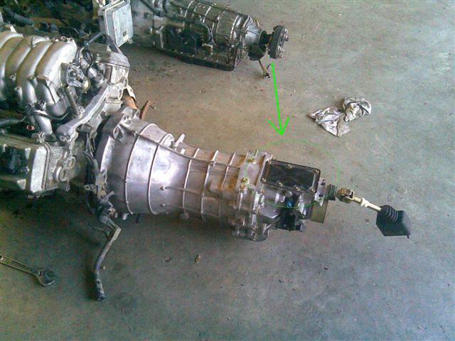

Guest ecKo. Posted October 30, 2007 Share Posted October 30, 2007 using a Lexus V8 VVTI and would like to know is there 2 different ways you can have the gear shifter on the box, i want to have it where the black cover is.Just woundering if the box came out in another type of can and there is a standard bolt in sifter any help would be real good Does anyone know much about it and would know where to get the shifter from? Thanks Quote Link to comment Share on other sites More sharing options...
ezzzzzzz Posted October 31, 2007 Share Posted October 31, 2007 I'd pull the inspection cover to determine if a shifter could mount here. I have my doubts but most anything is possible if you throw enough time and money at it. Quote Link to comment Share on other sites More sharing options...
Pop N Wood Posted October 31, 2007 Share Posted October 31, 2007 A TKO trans has a similar covers that can be used to mount a shifter in different locations. http://www.5speedtransmissions.com/dimensions.html Try calling the guys at the web site I linked above. They might be able to help you. Quote Link to comment Share on other sites More sharing options...

Guest ecKo. Posted November 2, 2007 Share Posted November 2, 2007 Dayz said: What transmission are you using, I didn't know toyota was making 6-speed standard tranny except the getrag in the supra! its a 350z gear box guy i brought it off said 2006 Quote Link to comment Share on other sites More sharing options...
BirdmanZ Posted November 2, 2007 Share Posted November 2, 2007 I have a Z32 trans in my car and was hoping that i could put a shifter in place of that cover. Long story short, I couldn't and i would bet that you can't either or at least not easily. What i did was shorten all the external shift linkage to make it fit into my car. Brandon Quote Link to comment Share on other sites More sharing options...
Guest ecKo. Posted November 3, 2007 Share Posted November 3, 2007 BirdmanZ said: I have a Z32 trans in my car and was hoping that i could put a shifter in place of that cover. Long story short, I couldn't and i would bet that you can't either or at least not easily. What i did was shorten all the external shift linkage to make it fit into my car. Brandon yea was just seeing if any1 had made one before or if something standard bolted in how did you go about hooking a speed to that box i cant seem to see a pick up for a speedo on the box Quote Link to comment Share on other sites More sharing options...

HowlerMonkey Posted November 19, 2007 Share Posted November 19, 2007 If you want a shifter where the plate is, use the pathfinder stuff. I'm building a L28et in a infinity M30 and are using the shiftter coming out of the cover. Who needs a short shifter when you can have a long shifter and be really cool? Quote Link to comment Share on other sites More sharing options...
Guest ecKo. Posted November 20, 2007 Share Posted November 20, 2007 HowlerMonkey said: If you want a shifter where the plate is, use the pathfinder stuff. I'm building a L28et in a infinity M30 and are using the shiftter coming out of the cover. Who needs a short shifter when you can have a long shifter and be really cool? pathfinder stuff? im very new to the nissan seen been a toyota nut for few years is this what you have used on your box got any pics was going to fab someing up but you may have a better way for me to try Quote Link to comment Share on other sites More sharing options...
HowlerMonkey Posted November 20, 2007 Share Posted November 20, 2007 I got my tranny from a 2 wheel drive pathfinder and it uses a shifter that comes in where the plate is but some things need to be added as well as changed if I wanted to mount the shifter where it is for a Z32 (1990-1996). Quote Link to comment Share on other sites More sharing options...
