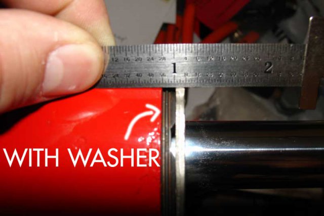

djbit Posted December 8, 2007 Share Posted December 8, 2007 Should I use the washer or no? Here are pics of the flange nut spacing with and without the washer. I am using the HP3516s for the rear. Doing install this weekend along with Eibach Pro Kit springs. 1972 240z Thank you all! Quote Link to comment Share on other sites More sharing options...
nbesheer Posted December 9, 2007 Share Posted December 9, 2007 I asked this question about my S130 and I was told do not use the washer. This was after I had driven my car with the washer and they came loose :| anyways the answers I got were S30 specific, so no washer. I'll look for the thread EDIT here you go http://forums.hybridz.org/showthread.php?t=126697 Quote Link to comment Share on other sites More sharing options...
EMWHYR0HEN Posted December 9, 2007 Share Posted December 9, 2007 As Long as the gland nut is tight against the strut youl be fine. Ive never seen anybody use a washer there. I too had the gland nut come loose on me. Cleaned it up, and a little thread lock or silicone solved that problem. Quote Link to comment Share on other sites More sharing options...
djbit Posted December 9, 2007 Author Share Posted December 9, 2007 Thanks for your input. I'll leave it off. edit: I could of sworn I saw that other link on this the other day...my big fat head. Quote Link to comment Share on other sites More sharing options...
