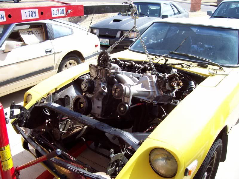

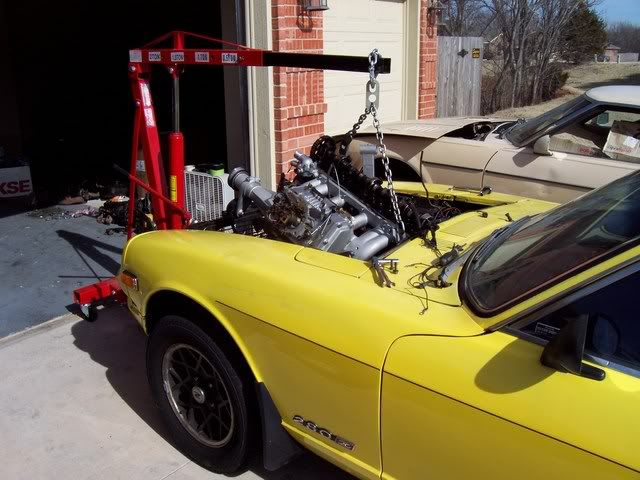

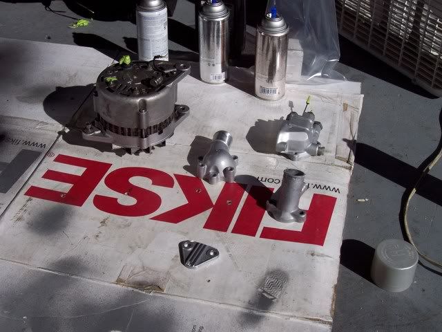

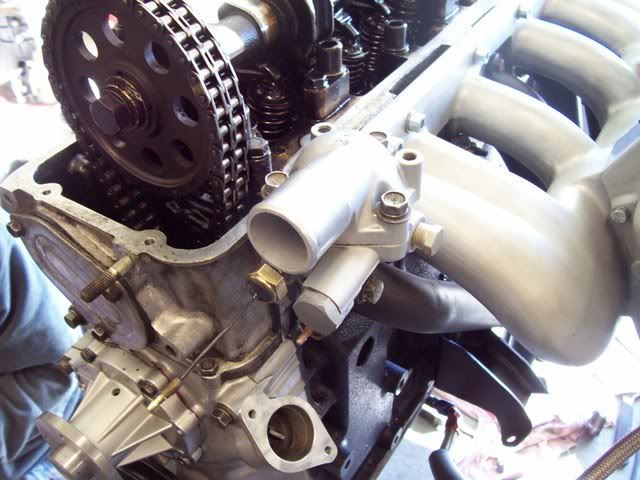

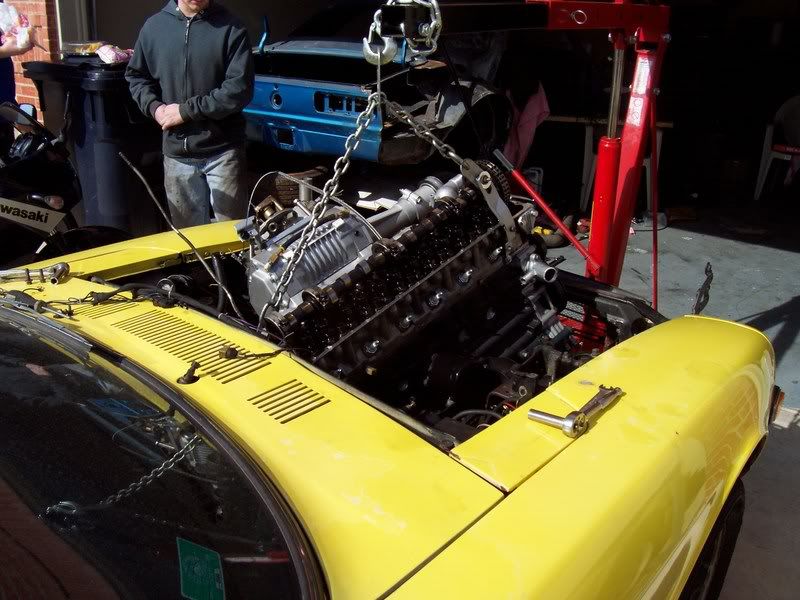

boardkid280z Posted February 16, 2008 Author Share Posted February 16, 2008 ya know... I've got a polished thermostat housing outlet (the part that the hose connects to) laying around that I could let go of cheap... Thanks, but I'm trying to keep the number of polished/fancy parts on my engine to a minumum. I had a chromed mech fuel pump cover and stripped it and painted it because it was too shiny . Big Update (sorry it took so long) First some pictures. Thermostat: Engine Install This was about 3 weeks ago on Saturday. The day before, Friday I got real sick, but it was so nice out and it had been so cold that we just had to drop the motor in. Then I got even more sick and layed in bed for 6 days. The next week we installed the radiator, electric fan, fuel lines, throttle cable, oil lines (I had to buy a special fitting; metric M12 to FIC -6 or something). Friday night (Feb 8) we got the thing running. Saturday I made a Y adapter to fit the two 2" header outlets to my 3" exhaust, reinstalled my Innovate wideband, did the wiring for the fan. I was trying to get it all done so I could drive it to our local Porsche club autocross on Sunday, just to show everyone. I was up till 6:30 Friday, and didn't sleep at all Saturday night. At the end of the night, she wouldn't turn over and we replaced the starter 15 mins before we were supposed to leave Sun AM at 8:15. As it turns out I think the battery was just low. But we drove to the autocross, smokin' the whole way. It was our first drive and I thought maybe it was the int/exh gasket burning a bit, but the smoke definitely didn't go away. Didn't have a hood because the thing doesn't fit. I think I'm gonna go get one from a junkyard, cut some holes in it and paint it black. We showed up at the AutoX and a bunch of people came over to check it out, they seemed impressed . Then 10 mins later a Ford GT showed up and everyone went to go look at that . It was cold though, and I didn't want to wait around, so we left after about 45 mins. The car was completely untuned and smoked all the way. Monday night we put some thicker oil in it and it seemed to smoke less. Then we took it out and tried to tune it (Megasquirt). There was a pretty bad exhaust leak, making things from the motor really loud, so we had a hard time discerning detonation/knocking from just noise, we had the timing set below 20 across the board anywhere in boost, and slowly turned it up, I think we were around when 25 at 6psi when something happened and lots of smoke started coming out of the valve cover and crankcase breather holes. The engine also sounded weird. A compression test yielded these results, 1-6: 90-140-140-140-140-90. As it turned out, after pulling the head Wednesday, we had blown the head gasket. At least on #6 there was evidence of it. At #1 it wasn't clear if there was a place where the gasket had blown. I should have had the head surfaced, because the surface is pretty torn up. So I'll have that done next week before I put it back on with a new gasket. Also I will be welding up the connection for the exhaust and adding a pre-muffler to quiet things down so we can listen for knockage. Sorry for the long post, I will download the rest of the install pics off my camera and post them up soon. And will let you know how things go once it's all put back together. Oh before I forget, here is a short vid of it running Sunday night with the exhaust: Mr.Insane - No internal bypass on the SC, I got a pretty good deal on the used SC kit, it was missing some parts, so a lot of it has been figure it out as I go. rztmartini and jesus - The JCR Supercharger kit is not for sale new at the moment as far as I know, I talked to Sandy Cook a while ago, but the kit production was on the shelf and it sounded like they were busy with other stuff. There is another company that has the manifold molds or something, but they also are not doing anything with the project from the last time I talked to them (6 months ago or more). More pics coming soon. Quote Link to comment Share on other sites More sharing options...
