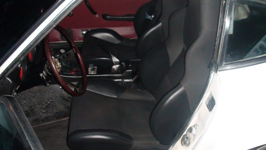

here are the final install pictures. The hi resolution links for each photo is below the particular image.
Notice the height.
http://photo.ringo.com/252/252133557O745675152.jpg
All the way forward, and it's very tight squeeze. This seat install is S.A.C. (short asian compliant).
http://photo.ringo.com/252/252133564O383960259.jpg

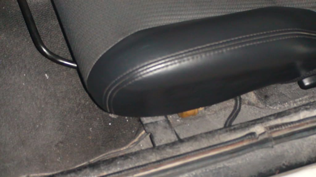

Are those holes I see in the floor board? Notice the lower rear of the seat, it rests against the seatbelt mech, in other words full motion. Good enough for someone about 6'2 in my estimates. I am 5'7, my dad 5'10, and he could not reach the pedals this far back.
http://photo.ringo.com/252/252133574O139739855.jpg
On the inside you have 1 inch clearance to the tunnel. Nice and snug fit and aligns the driver up with the steering wheel. instead of rubbing your shoulder on the door, you will rub shoulders with the passenger!
http://photo.ringo.com/252/252133605O074018263.jpg
To the cat that left the nice mark on the seat: Your fate awaits you. For the rest of you... notice the easy access to the backrest lever, it's about 2 inches clearance. Your fate awaits you too, but I'm sure it much better than the cat's.
http://photo.ringo.com/252/252133610O995129314.jpg

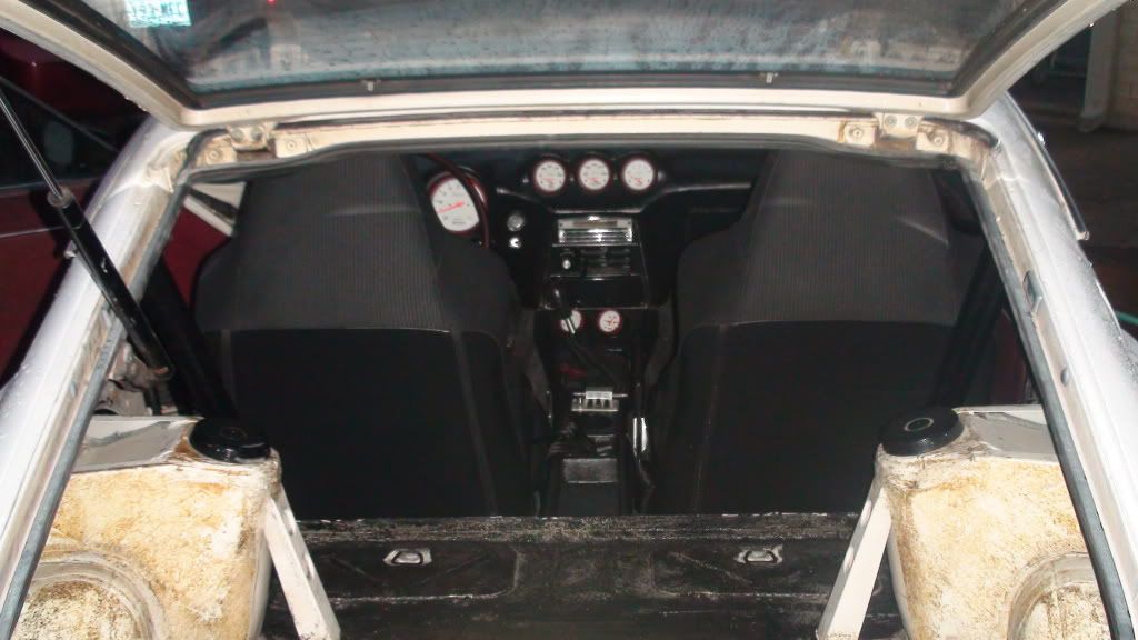

Passenger side. This is all the way back for the backrest in that angle. If you push the backrest forward the rear of the bottom portion of the seat will hit evenly on the inner and outer seatbelt mount points. Take your time aligning them to get it right, it will pay off.
http://photo.ringo.com/252/252133622O767732539.jpg
The only downside to this side to side alignment is that the new hole that you drill on the inner mount point. The position is not totally flat. Liberal application of force on tightening the nuts up seems to resolve this. I may get creative with the new welder and some flat stock to rectify the situation.
http://photo.ringo.com/252/252133631O637983956.jpg
A better shot of the passenger side head rest clearance. It's pretty good, about 2 to 4 inches.
http://photo.ringo.com/252/252133635O739555407.jpg
Thats it for the fitting of the seats. I still need to remove them and get the brackets painted and pictures of the brackets themselves. I need to get the seats cleaned as well.
