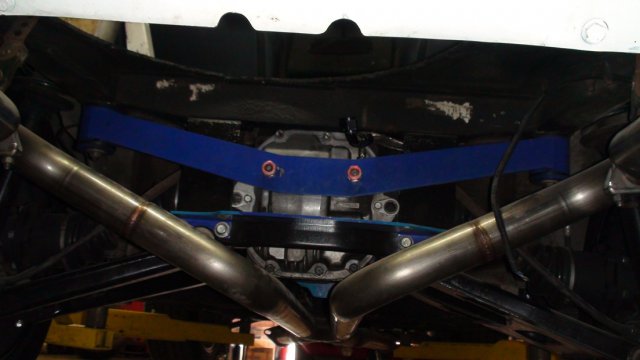

  2. Been around the car for years, but never when it was on a lift. Wish i had that torque tube set up. Took a couple pics the other day. See beauty and the gnarly beast below. I also have DarthZ

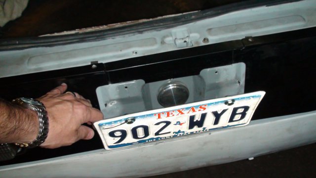

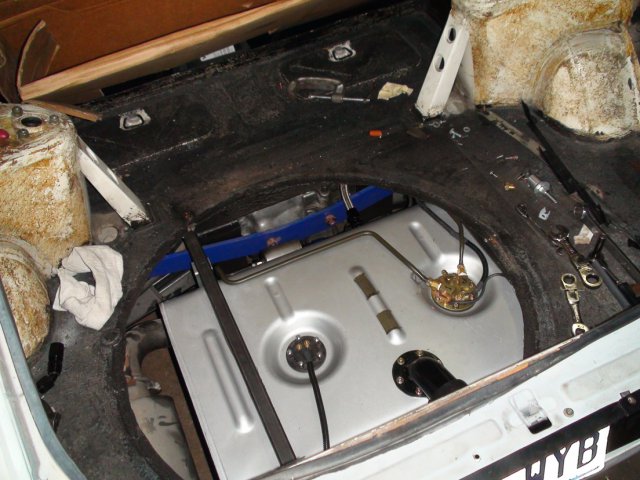

  3. The torque tube idea was cool, but was a real PITA to set up...thus it didn't make it into the kit. We need to crawl under his Z to find a "phantom" noise anyway...will try to take some pics then. I will post a few more pics of the car. I just don't have any of it as it sits right now. Let me know what pics you may want to see of Phantom's car and I can take a few of those as well. His car is really nicely done. FYI. If you live in Texas, John's cars parts out v8 installation work to Larry at www.larrysspeedandcustom.com He is a good guy and the installation work is Very well done and he really cares about his customers. Tell him Eric Davis sent you out from this site. This little bit of info could save you a LOT of money versus going with anyone else for the work and he is already very familiar with our cars as his first work on these cars was with my Dad's set up in 2000 and just completed some work on my car a couple months ago. This was my answer to the exhaust / fuel tank.... The tank can be found here: www.tanksinc.com

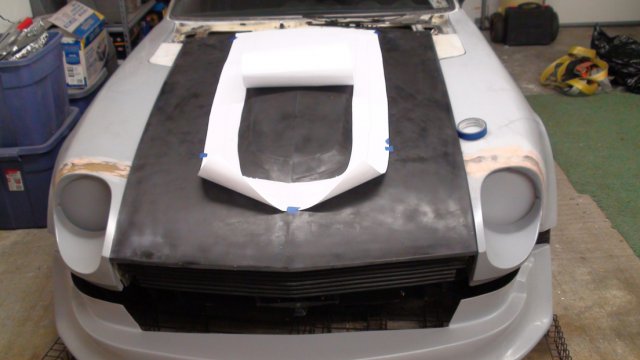

  4. OK, so i ran into a few problems. One small one was that the paper template that comes with the scoop does not account for the shape of the hood. It was easily handled by centering up the template, then trimming out the middle of the paper that would run over the bulge on the hood. The not-so-small problem is that the j clips are not installed into the fiberglass symmetrically they are a 1/4" off hear and another 1/4? off there. The template does match the Off-placed bolt holes, but one of the holes on the back edge, by the windshield is set too far forward placing it directly over the edge of the hoods frame. This means you ether need to cut up frame or get your own clip and set a new hole. The scoop itself is in good shape, but I would have preferred it just came with a few clips versus them being installed semi-randomly. I plan on shooting an email to Les to let him know as well. Unfortunately, I trusted the template, and drilled holes prior to realizing it was right over the frame rail. Maybe it will save some of you guys the hassle I know have of dealing with some extra holes. I just looked at my own pic and realized the holes are pretty obviously "off".... look at the two near the back edge...the one on the passenger side is the culprit!
