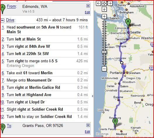

My 280zx turbo. Poik (turbobricks and ls1tech) and I drove from Edmonds, Washington, to Grant's Pass, Oregon, to get a Turbocharged 280zx with T Tops, because there were like two in Washington for sale, both of them being rust buckets.
Note: long. f*cking. Drive.

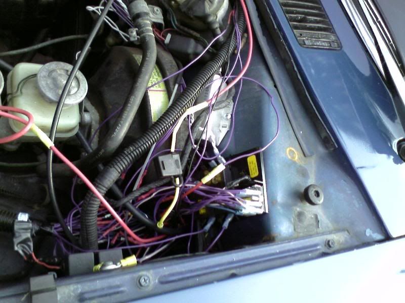

Here are a couple pics of the first iteration of my megasquirt harness:
The men in my family are all electricians.  This wiring job was shameful.

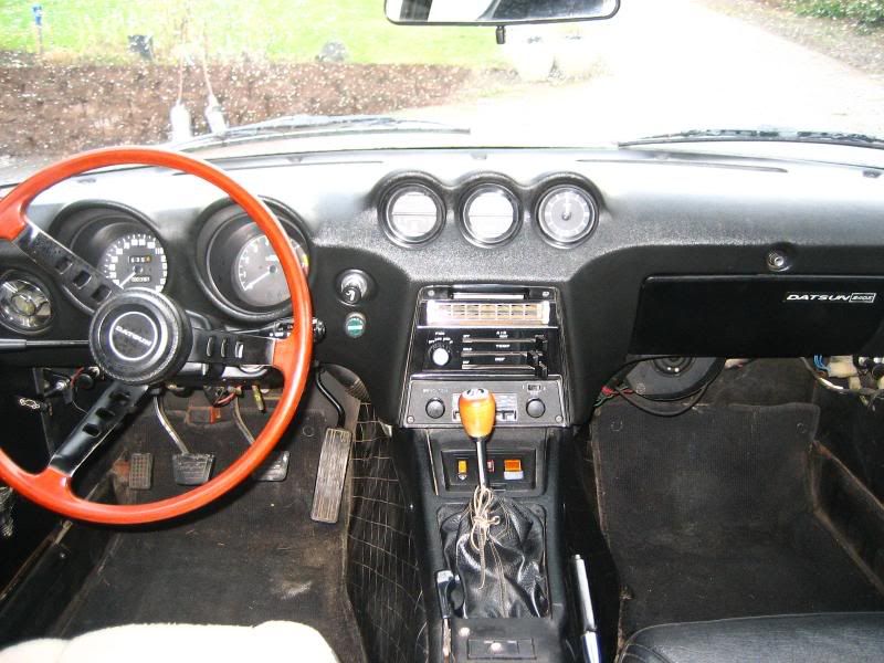

The dash, is frickin perfect. I saw the dash, and knew this was the car for me. I've never seen an interior in as good of shape (without restoration) as this car. I decided that was a good indicator and bought it.

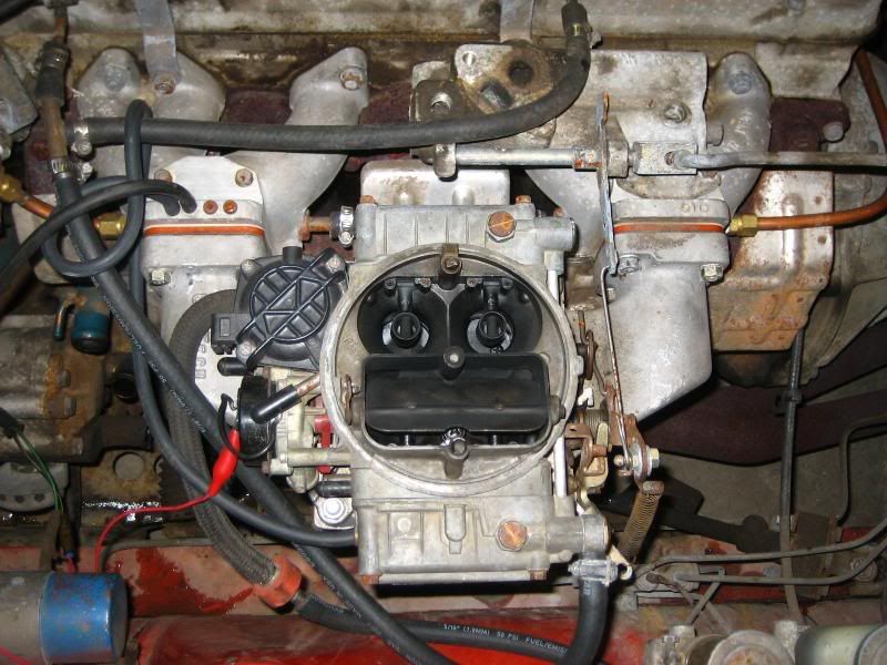

I bought a brand new Holley 390, as well as the 4 barrel intake from http://www.arizonazcar.com. I powdercoated the manifold black:
I did not get a pic when it was all done (like having the carb installed), but you've seen what it looks like. Imagine the first pic without carbon buildup.

So, After the new carb was installed, and everything was all gravy, I drove the car. Whee. That little sucker hauled ass.

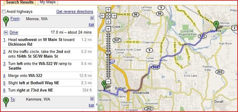

So, Monday morning, I get in my car (didn't check the oil this time), and got on the road. I got from Monroe to Kenmore:
Before I noticed a rattling sound. I immediately pulled over, checked my oil. Bone dry. I walked to shell, bought 5 quarts of oil, dropped it in the motor, and checked the oil. The motor was hot, so all the oil heated up and dropped to the pan, and the oil came up to the "okay" mark on the dipstick. I drove to work, and worked. After work, I checked my oil, it was full. The motor, was not leaking any oil. I drove home. On the way home, however, the L24 went tits up. There was no oil sitting at home on the driveway where it was parked for the weekend, and there was no burning oil smell to the exhaust. CERTAINLY NOT 5 QTS IN 20 MINUTES OF DRIVING worth of burning oil smell.

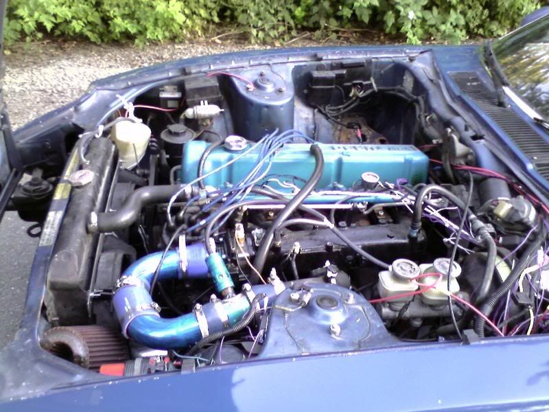

I swapped the turbo motor into my s30. Whee! I also rewired my MS Harness. It sort of looked like this:

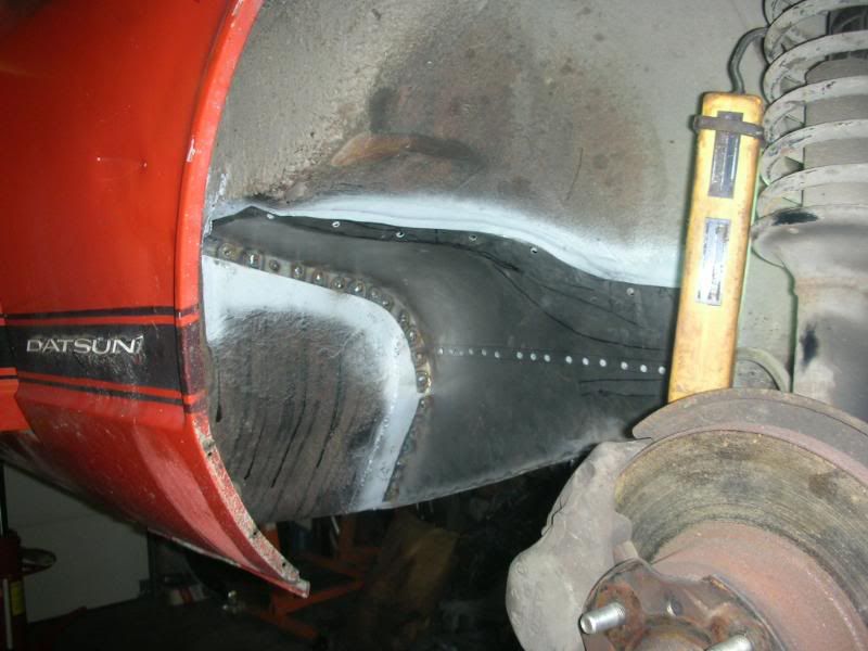

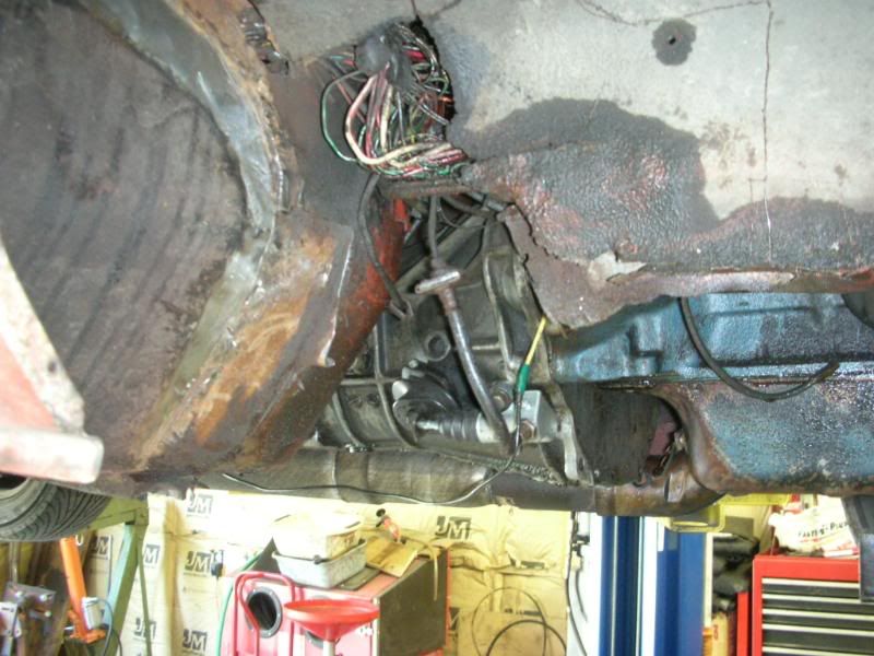

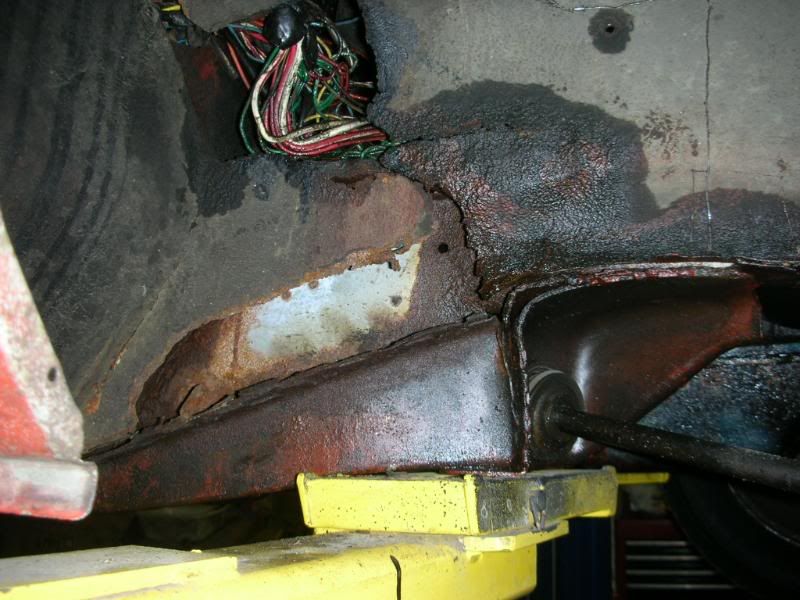

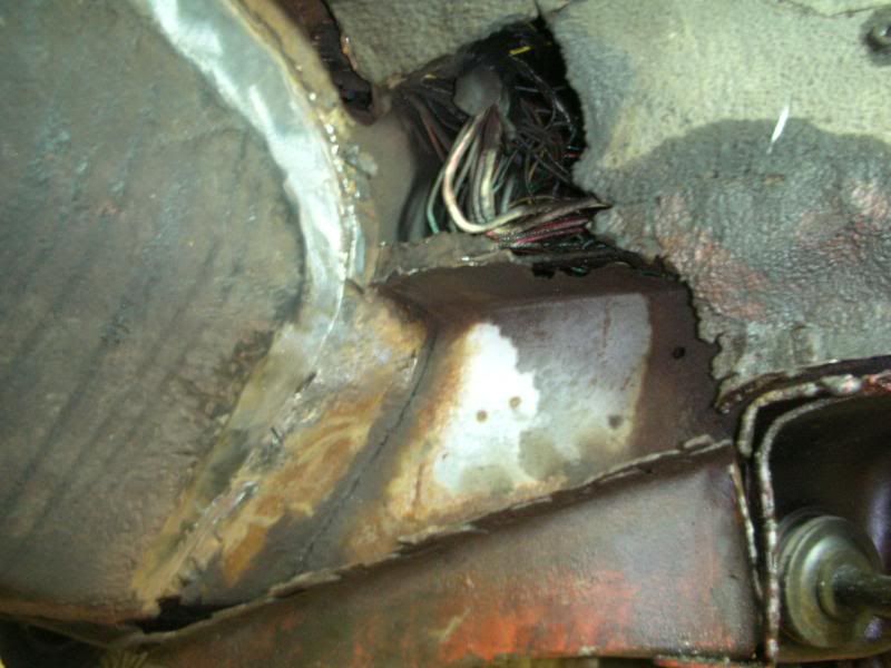

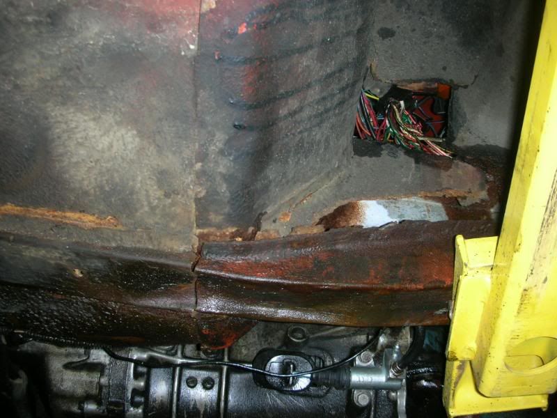

Next up in the list of fun stuff which has been a pain in my ass: Replacing the passenger side frame rail. Suddenly the car started veering right really hard when I hit the brakes. Turns out the subframe rail was rusted through and needed to be replaced. I replaced it with a piece from http://www.baddogparts.com/. It was an awesome piece, and I'd recommend it to anyone who needs to replace their frame rail.
Luckily, my neighbors build cars. Their work is ******* amazing. They restore Jensen Interceptors. I'd never heard of a Jensen before I met Doug and Keri, but they seem to be really great cars. Anyhow, Doug allowed me to use his shop to replace my frame rail, and when it became apparent to him that I didn't know what the hell I was doing, he helped me out by essentially doing the whole job for me. Essentially, I'm in debt as far as work time goes. Whenever I'm at my parents place and I have a spare minute, I ask him if he needs any help. He really bailed me out, and didn't ask for anything in return.
Anyhow, here are the pics!
Before any work:

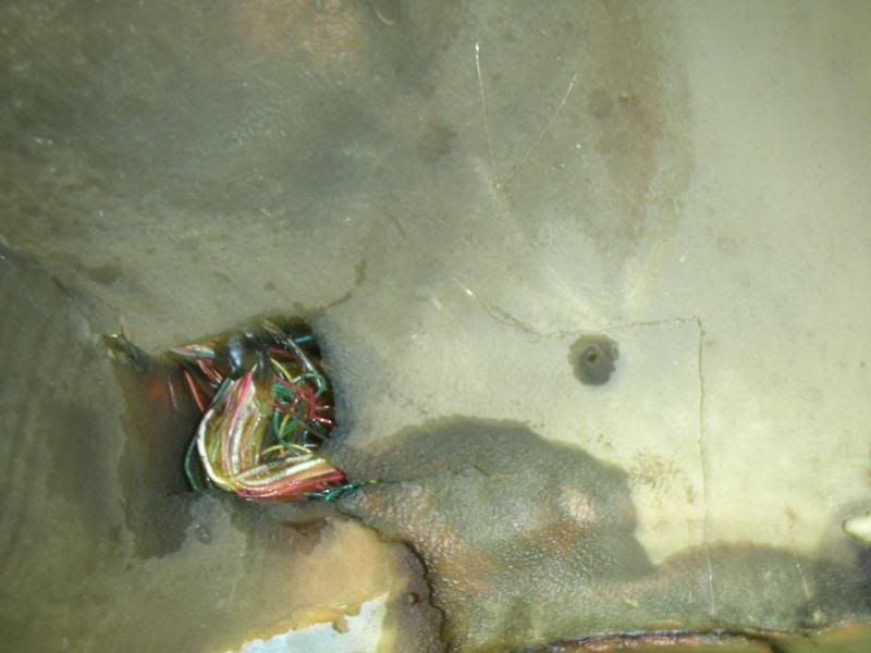

So, Doug told me to start cutting shit away. Here is that:

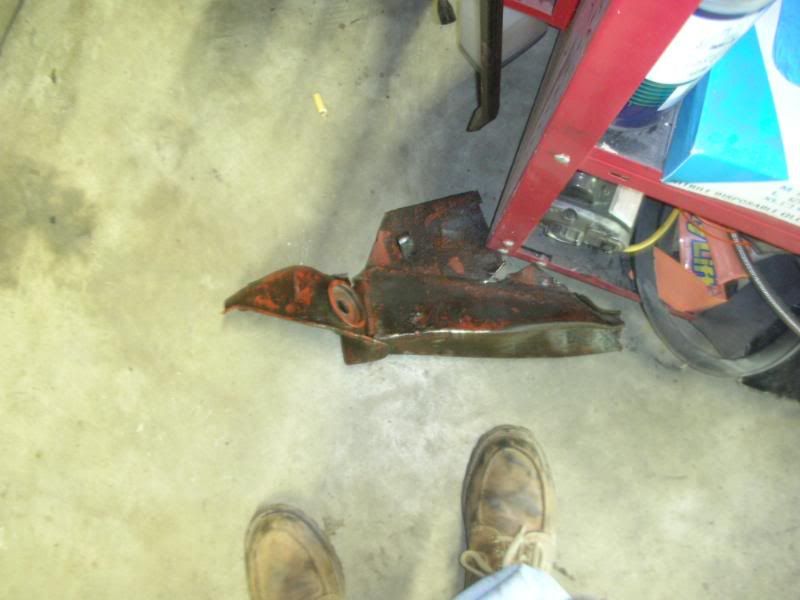

He asked me to pull this in one piece, so we could use it to fabricate other pieces:
Edited by badjuju

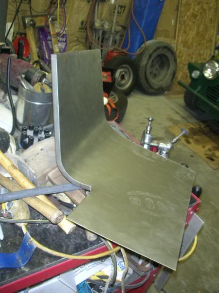

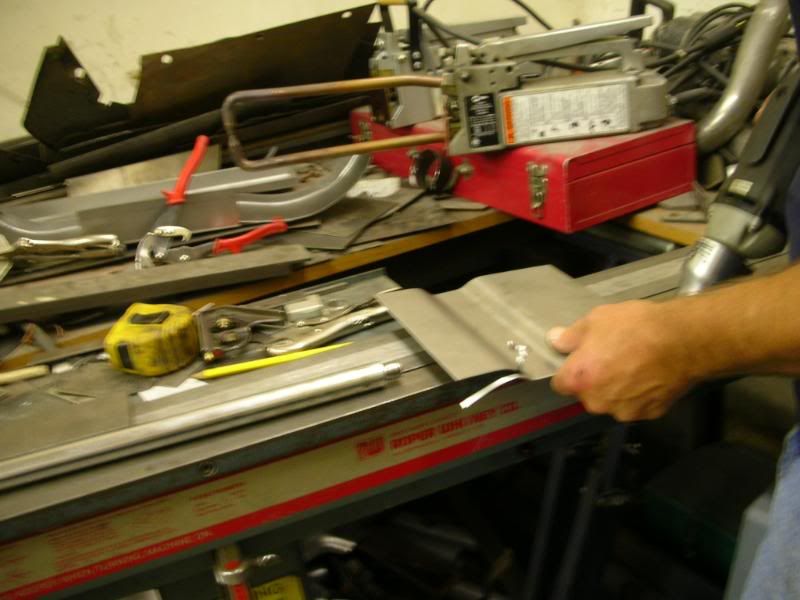

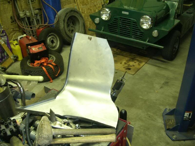

So... After measuring all that we had to fab, we started bending:
Then we bent some more:
From another angle:

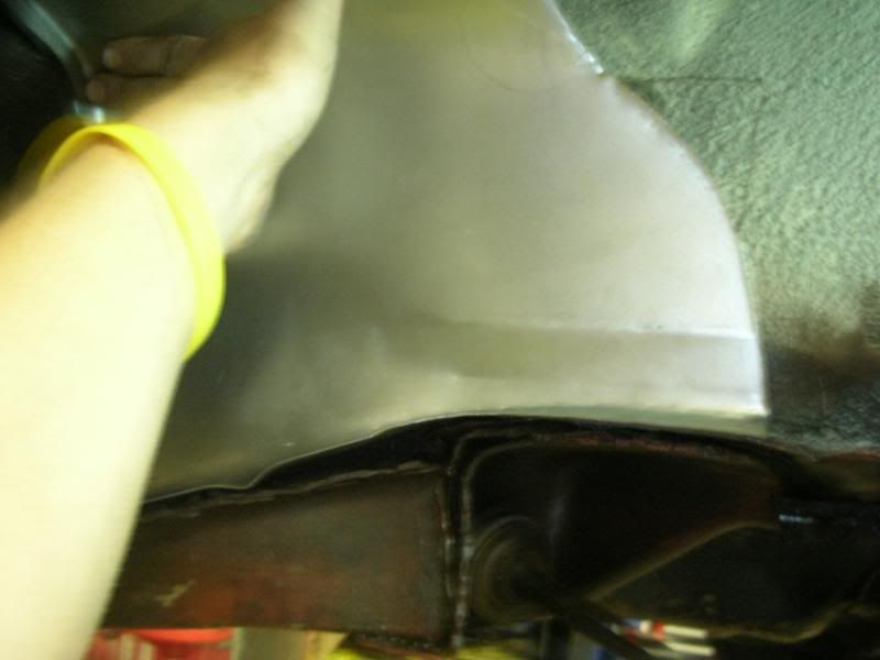

How's it fit?
A little floorboard repair while we're at it, Poik helped out here:

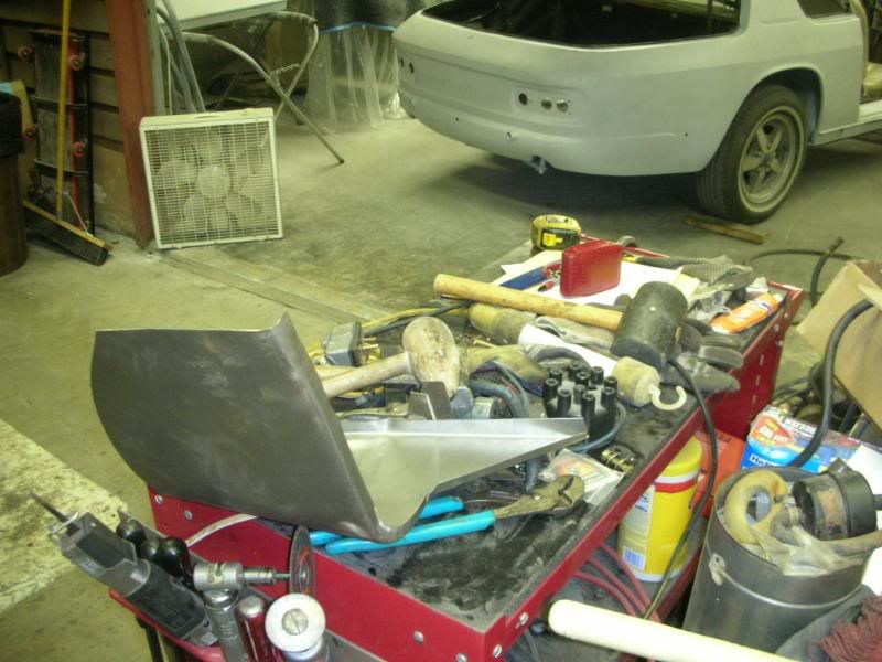

Building an end piece for the new frame rail:
Ripped the old frame rail out:

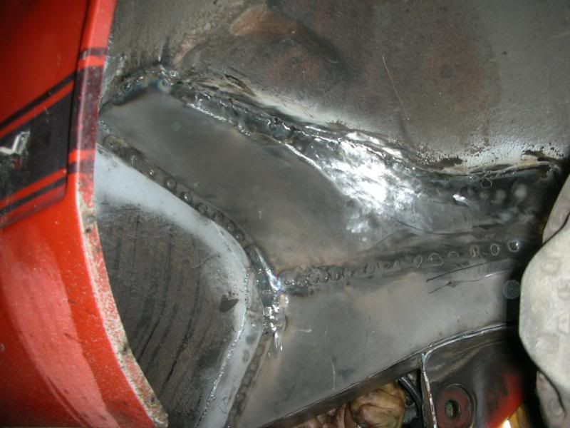

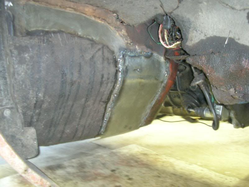

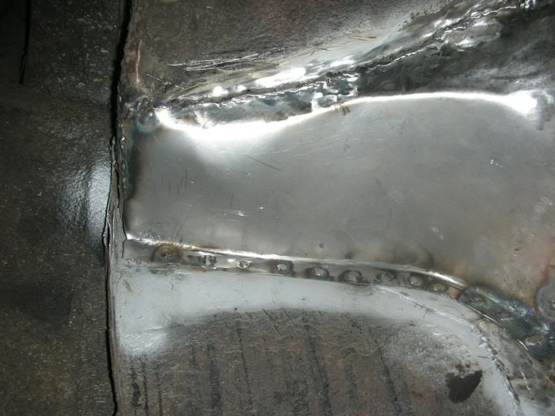

Welded the new wheel well in:
Fitting the new rail:

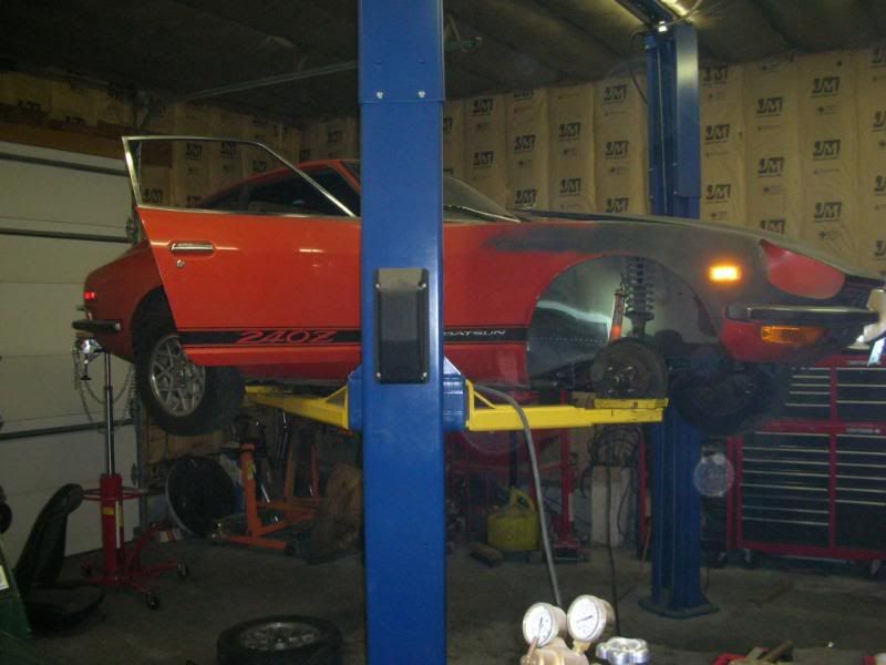

Didn't take any after pics... damnit, lol
I'll take some the next time it's on a lift.

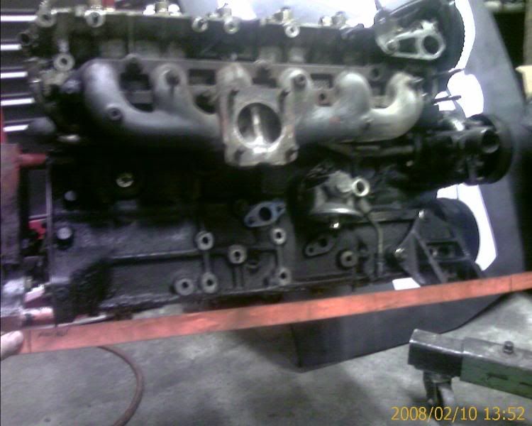

The motor:

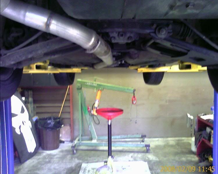

I plan to cut the exhaust at the first bend and just rotate it 180*. I hope to.
And just for the hell of it, we dropped the motor in with a crane to see how badass this thing will really look.

BUUUUT, My friend Poik from over on TurboBricks came over yesterday and mentioned he saw a 2jz-GE in a Lexus SC300 at the junk yard. We rallied, and with the help of a sledge hammer, a sawzall, a crowbar, and a #14 on a ratchet, I walked out of the yard with a front clipped 2jz-GE with 97k miles on it for $180.
So... this project may be changing around quite a bit. lol
I wasn't aware the oil pan would need fixin, I figured since they were both rear sump it wouldn't be an issue. Guess I need to research some more, lol
