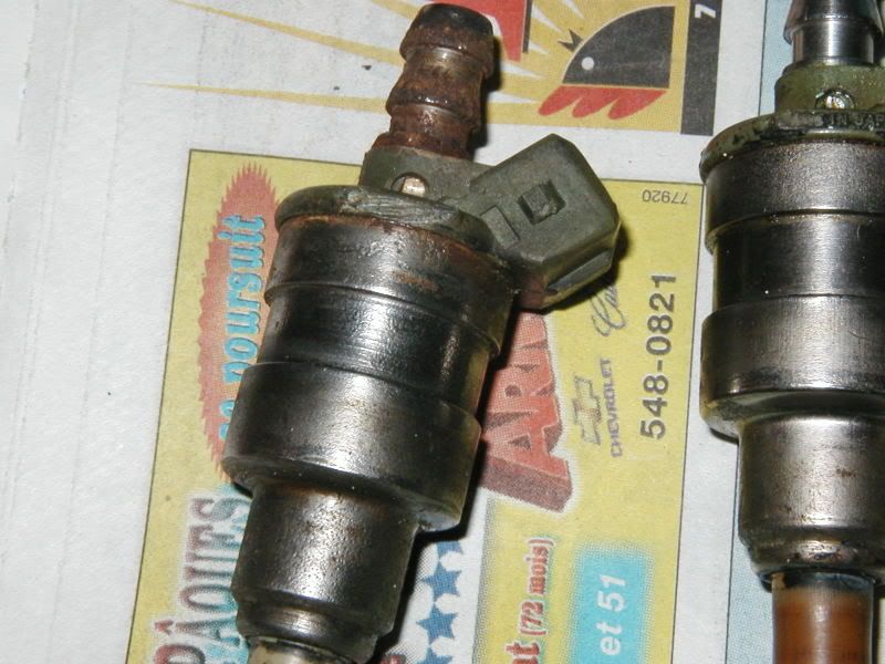

Wedge Posted April 9, 2008 Author Share Posted April 9, 2008 Thank you very much ! Thats what i did i cut the ring then cut the tube with a knife i may have to clean them they got durt in the tiny filters . I just took a picture injector 1 has rust on the barbs can i clean it or i need a new injector ? Quote Link to comment Share on other sites More sharing options...
Guest 280zfast Posted April 9, 2008 Share Posted April 9, 2008 you canclean it with car and choke cleaner, or yuo could leave it like it is its really up to you. Quote Link to comment Share on other sites More sharing options...
MJLamberson Posted April 9, 2008 Share Posted April 9, 2008 If you soak them in B-12 chem tool fuel injection cleaner they will come out nice and new looking, the electrical connections as well, If they dont work right then when they are on the car run a high pressure fuel injection cleaning system through them, cheaper then new injectors . Quote Link to comment Share on other sites More sharing options...
