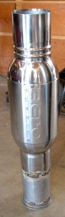

Guest 280ZForce Posted April 15, 2008 Share Posted April 15, 2008 I'm using 4" in/out mufflers from a brand called Aero Exhaust, the 4" mufflers are listed for their diesel truck applications. But it works for me and for $150 it's not bad at all. http://www.aeroexhaust.com/diesel_muffler_4040.html Link to comment Share on other sites More sharing options...

mattyice Posted April 15, 2008 Author Share Posted April 15, 2008 I'm using 4" in/out mufflers from a brand called Aero Exhaust, the 4" mufflers are listed for their diesel truck applications. But it works for me and for $150 it's not bad at all. http://www.aeroexhaust.com/diesel_muffler_4040.html do you happen to have any better pics of it then that one that is one their site? Link to comment Share on other sites More sharing options...

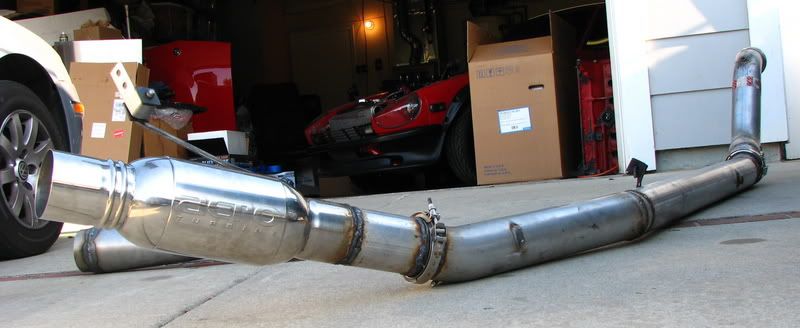

Guest 280ZForce Posted April 15, 2008 Share Posted April 15, 2008 This was my old 4" turbo back system... but with the way my car sits now on coilovers, 4" round sat way too low so I've gone to oval piping after the downpipe and then made a oval y-pipe to run duals, then after the diff they go back to 4" rounds and 1 exits each side. But here's pics of the old 4" turbo back setup I built. Link to comment Share on other sites More sharing options...
mattyice Posted April 15, 2008 Author Share Posted April 15, 2008 damn that looks really nice!!! i might have to look more into those mufflers, with having a fuel cell and it only being a weekend warrior for me, the ground clearance isnt much of an issue to me... Link to comment Share on other sites More sharing options...
Guest 280ZForce Posted April 15, 2008 Share Posted April 15, 2008 damn that looks really nice!!! i might have to look more into those mufflers, with having a fuel cell and it only being a weekend warrior for me, the ground clearance isnt much of an issue to me... The fuel tank is not the issue for clearance, if you are on just normal lowering springs you will be fine. The lowest point of our exhaust systems come right around the back of the diff going under the back corner of the control arm. On my old tokico HPs and tokico springs I had about 3.5-3.75" ground clearance on the low spot, once I went coilovers and dropped it I had 2" clearance. I am now also running a fuel cell and that's another reason I decided to go duals as well... w/ high hp turbo engines, you can never have too much exhaust air flow. So splitting to duals will only help providing it gives more air flow. Link to comment Share on other sites More sharing options...

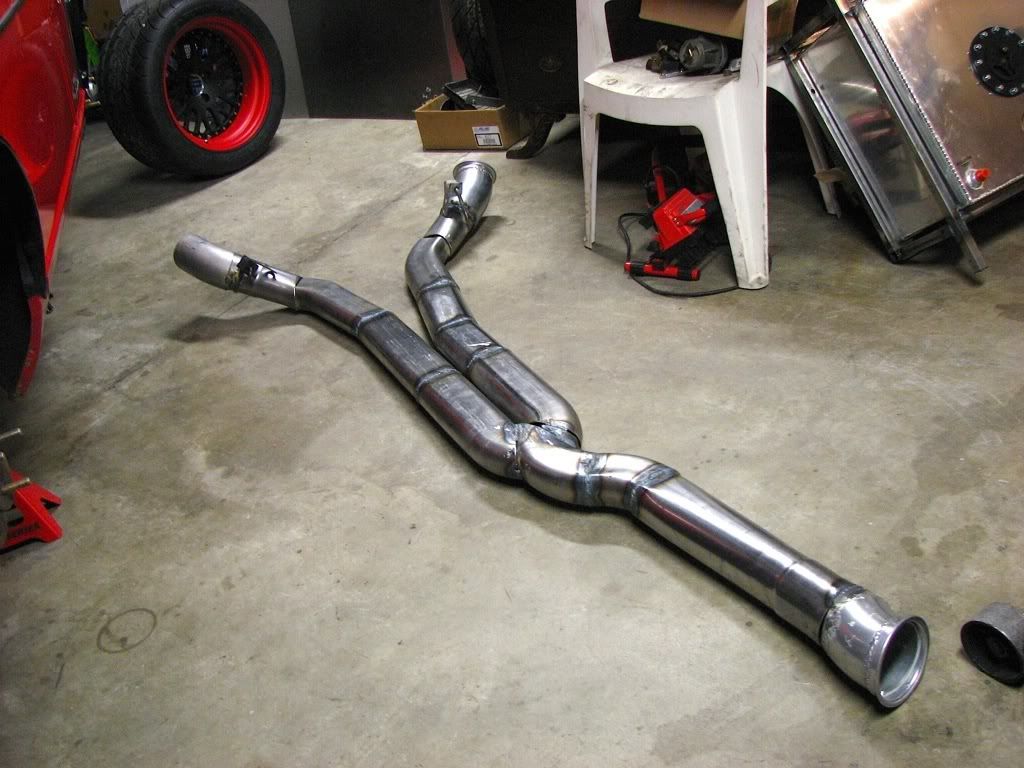

Guest 280ZForce Posted April 16, 2008 Share Posted April 16, 2008 I ended up doing a custom x-member and having fun w/ cutting up ovals...what a pita. The ovals now sit even/above the frame rails. This is while I was in the process of building it... and missing 1 muffler cuz I'm still waiting to get it in the mail... 4" downpipe then oval transition, oval y-pipe to dual ovals, then after diffy transition back to 4" rounds and exit dual 4" inlet mufflers... Please excuse the hack job, it's all under construction Link to comment Share on other sites More sharing options...

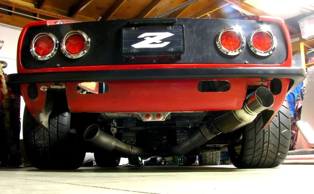

Guest 280ZForce Posted May 1, 2008 Share Posted May 1, 2008 it's not done, cuz I still need to clean up around the back and make it look nice... but gives you an idea of running dual 4" exhaust w/ dual 4" inch inlet mufflers... Link to comment Share on other sites More sharing options...
