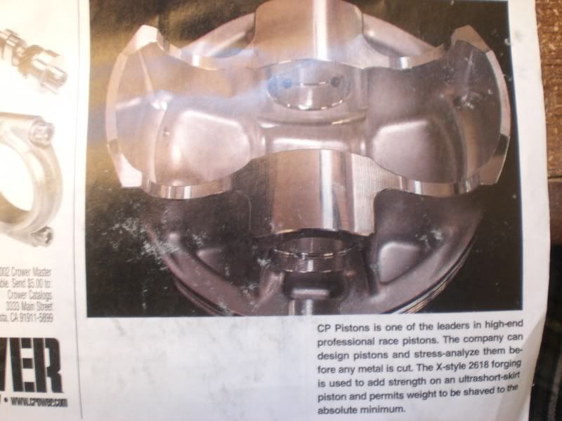

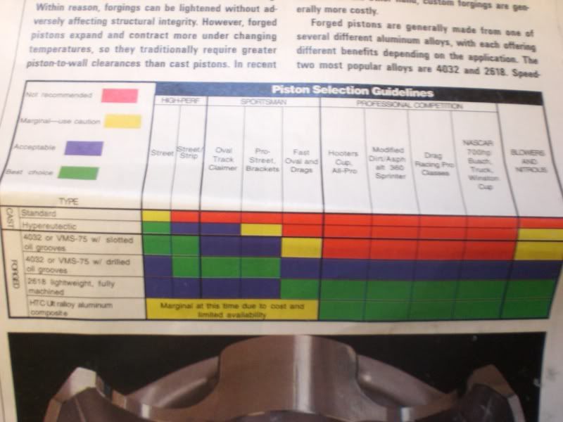

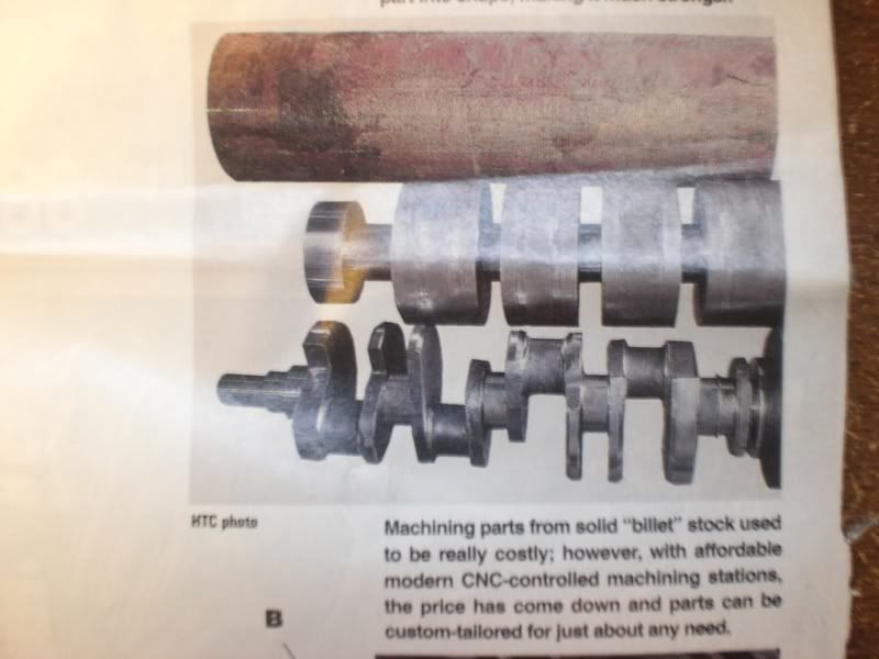

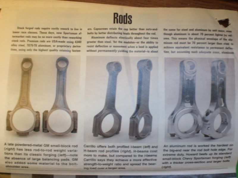

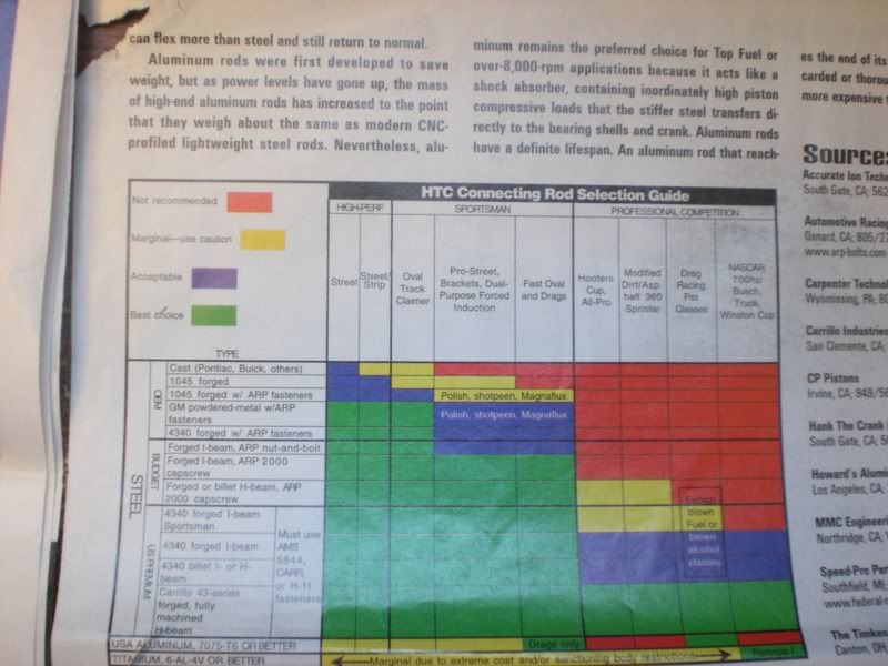

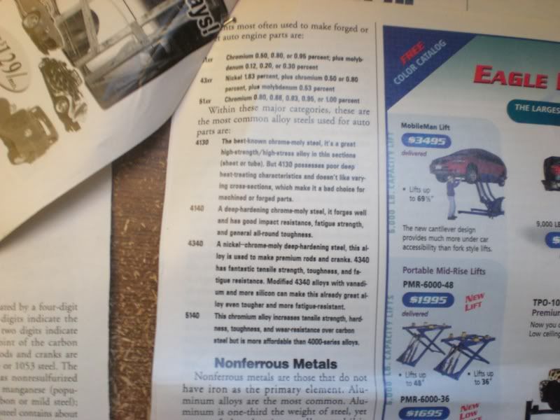

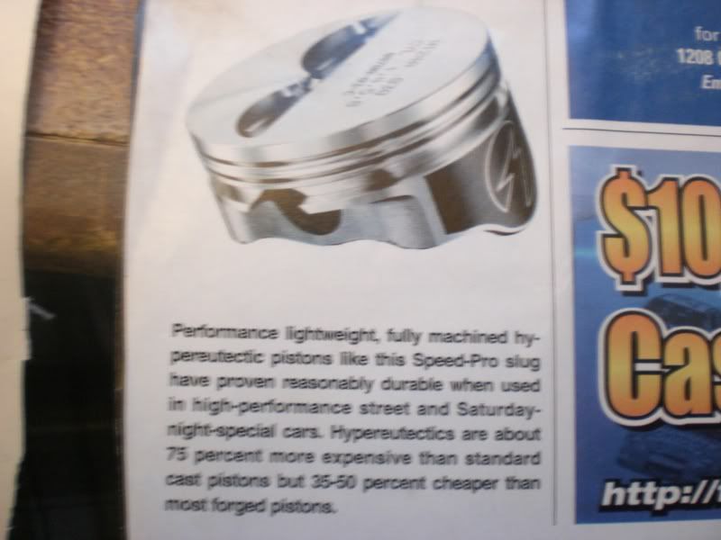

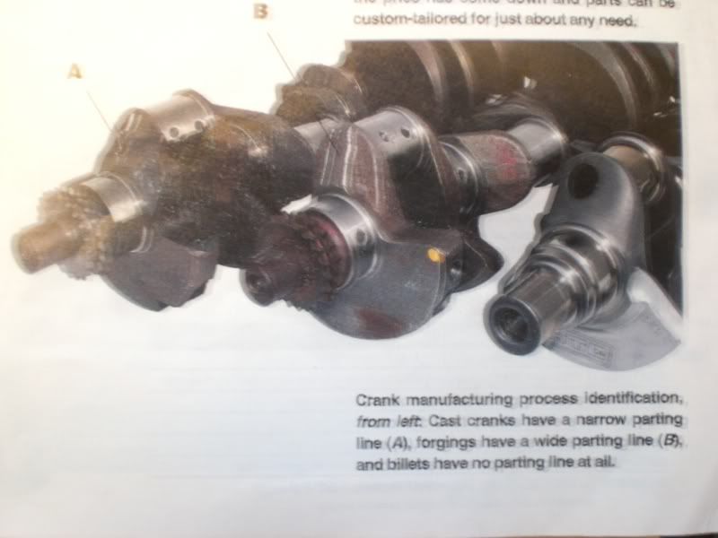

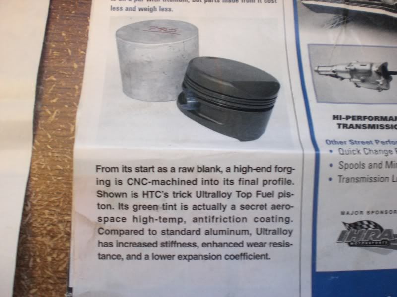

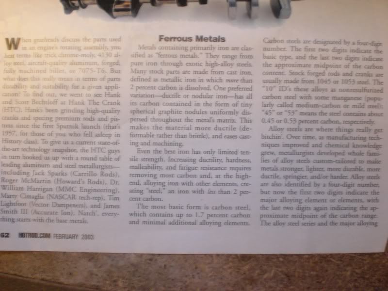

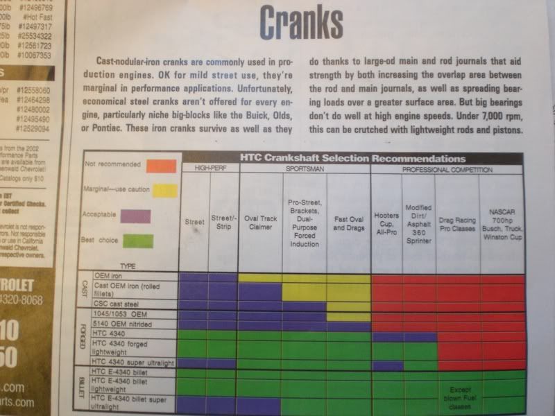

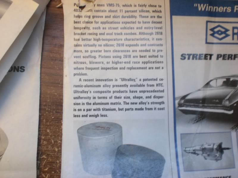

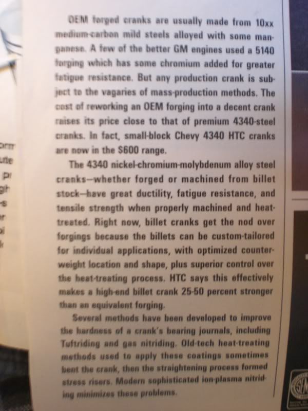

Not to change the subject but my dad just got a call today from one of his customers saying he blew his motor today during practice for this weekends races in our club (Dad builds race motors). At first he thought it was gaskets or something due to the 12:1 comp. motor. Its a Triumph so 12:1 is a grenade for them. Go fast for an unpredictable amount of laps, personally I'd rather have a reliable motor. Anyways, he literally blew up a piston. As in... the piston blew down into the oil pan and the wrist pin is still on the rod. Stock pistons connected to polished, lightened, deburred, and shot peened rods that Dad did.
This is another example of die hard projects which have been done cheaply. I am at fault too with my stroker project when it comes to some things. Any and all of us who wish to do hot motors, do it right the first time. I'll try and snag the piston if he doesn't want to keep it as a Doah! Trophy.
Sorry 56k users....
