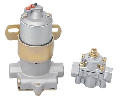

Holley 12-327-11 $75 PUMP
Holley 12-803BP $67.39 regulator

if you want a steady and fully adjustable pressure fuel flow youll need a return line style regulator and a decent pump in the 80-140 gph range matched to the correct sized fuel lines
http://www.centuryperformance.com/fuelish-tendencies-understanding-fuel-pressure-and-volume-spg-140.html
theres a good deal of usefull info in this link above
do the job correctly the first time and avoid the problems and guess work and testing ,cheap auto store replacement stock pumps usually get you envolved with

DO YOURSELF A BIG FAVOR and don,t slap the cheapest P.O.S stock replacement type pump into the car with no return line or regulator and no fuel pressure gauge,...... youll be FAR better off with a RETURN LINE and FUEL PRESSURE REGULATOR installed and a fuel pressure gauge so you can instantly adjust and check your fuel pressure, even if you use a electric fuel pump, keep in mind electric fuel pumps PUSH fuel far more efficiently than they PULL fuel and electric pumps use the fuel FLOWING THRU them as a COOLANT, so mount the pump as close to the lower surface level of the fuel tank and as far to the rear of the car, inside the frame rails as you can.

ADEQUATE (for your current set up)
http://store.summitracing.com/partdetail.asp?autofilter=1&part=CRT%2DP4601HP&N=700+115&autoview=sku
OR
http://store.summitracing.com/partdetail.asp?autofilter=1&part=SUM%2DG3136%2D2&N=700+115&autoview=sku
BETTER
(and YEAH ID SURE INSTALL a return line,regulator and fuel pressure gauge)
