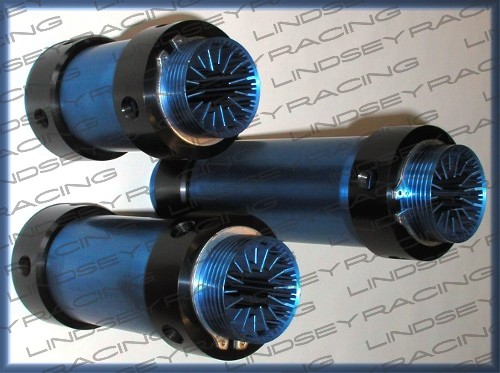

Put a hood scoop on the driver's side and put an intercooler right there(Impreza WRX style) to keep the intake tract short, or use an air/water intercooler. Maybe like one of the LINDSEY RACING intercooler units.
