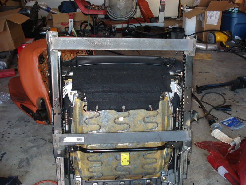

Z-drive Posted June 19, 2008 Share Posted June 19, 2008 so i seem to have stumbled across a set of 350z seats,.... for 175 dollars!!! i am pretty excited about getting rid of my ragged out recaros. the rails for the 350 seats are way to wide for my 280 so i have to completely remove them. I was hoping someone on here has done it before and could show me how they did it. Quote Link to comment Share on other sites More sharing options...

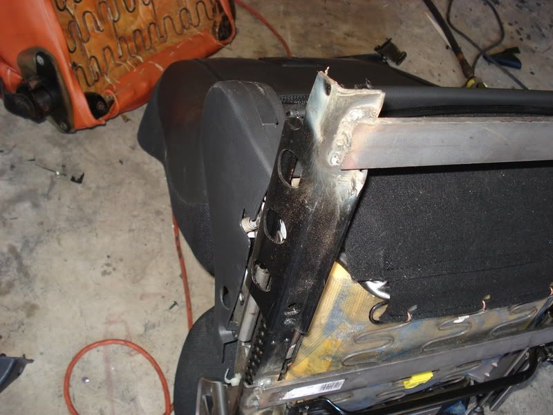

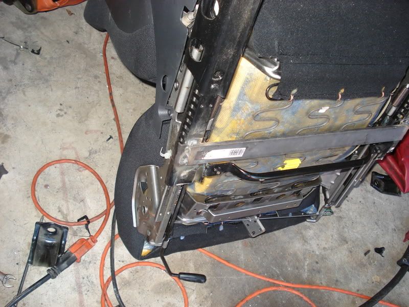

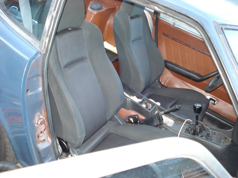

jeffer949 Posted June 19, 2008 Share Posted June 19, 2008 Quote Link to comment Share on other sites More sharing options...
Challenger Posted June 19, 2008 Share Posted June 19, 2008 Beautiful!! What year are they out of? Quote Link to comment Share on other sites More sharing options...
Z-drive Posted June 19, 2008 Author Share Posted June 19, 2008 Nice, I was thinking of something along those lines. Quote Link to comment Share on other sites More sharing options...
jeffer949 Posted June 19, 2008 Share Posted June 19, 2008 umm not to sure i think an 04 if im not mistaken. They are just the base model seats. Im 6'1" and with the seats all the way back im where i want to be on the pedals but i cant really go back any farther. The seat belt recoiler thing stops it from going back any farther. I Plan on going with 4 points so that will change later. with the seats where i want them to be for agressive driving i have plenty of head room(well unless my hair is long and spiked up. then my spikes hit lol)like 3 inches. or more and thats with the seat lifted as high as it can go. and i fit with a helmet on real easy. Quote Link to comment Share on other sites More sharing options...
jeffer949 Posted June 19, 2008 Share Posted June 19, 2008 Oh btw those are the stock z sliders dismantled and just using the bottom portion of them and welding them on. Then they just bolt right up. Quote Link to comment Share on other sites More sharing options...
Z-drive Posted June 19, 2008 Author Share Posted June 19, 2008 it must be a very snug fit using the stock ones Quote Link to comment Share on other sites More sharing options...
