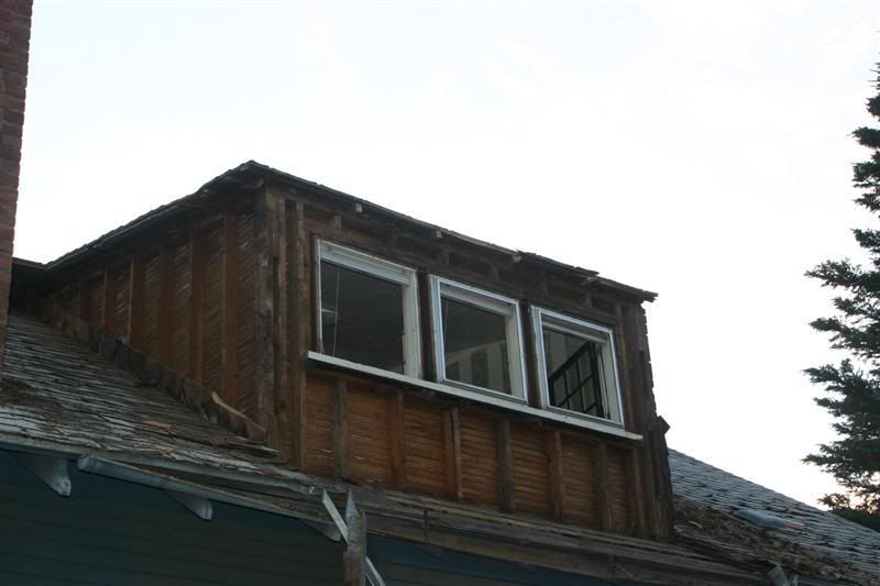

I will be stating on my other dormer soon in order to increase living space for my son as he grows.
I will post some pics of before and after:)

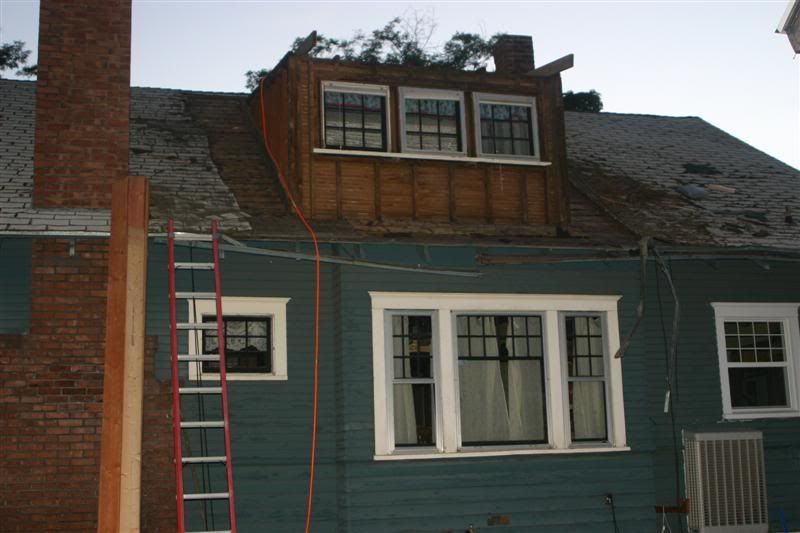

Anyhow.... Friday Starting at 3;00pm
Saterday
And I missed sunday's shot. It was mostly sheeted, the roof after the the 2x6 rafters were sistered up to the old 2x4s.
Jim, my neibor is helping me, very fine man! (Old school)
