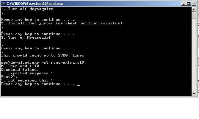

jeffer949 Posted August 24, 2008 Share Posted August 24, 2008 Ok well I finally got my car put back together yesterday and was taking it for a drive and it started raining. I was driving and then my engine just died. So i pulled over and tried starting it again and it wouldnt start. Checked my injector pulse with my noid light i keep in the car and nothing. Tried some starting fluid and nothing. So i wasnt getting fuel or spark. Then i checked the lights on the MS and nothing no lights what so ever. So crap what now? I was close to my friends work so i grabbed his jeep and went home and grabbed my stim and laptop and everything. Went back and plugged my laptop in and turned on my car and nothing no connection what so ever. It was raining so i unplugged my MS and just take it home with me. So im at home and i have my friends MS that he hasnt installed yet to work with and i get my stim working and get all the lights on the stim working correctly. But it wont connect to Megatune. If i open up the mini-terminal i do get the repeat if i type a letter so its communicating but not completely or something. I thought that maybe i got the processors mixed up and from my friends MS and that the it didnt have MS software installed so i tried to install the INI file and i got this message Now what to do after this I have no clue. Any help would be appreciated. Or if anybody has any ideas. Quote Link to comment Share on other sites More sharing options...

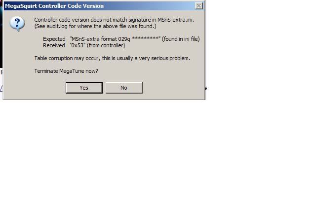

jeffer949 Posted August 24, 2008 Author Share Posted August 24, 2008 Im also getting this screen when i load megatune if its any help Quote Link to comment Share on other sites More sharing options...

Matt Cramer Posted August 25, 2008 Share Posted August 25, 2008 Im also getting this screen when i load megatune if its any help That message usually shows up when you have MegaTune set to the wrong COM port. It happens when whatever MegaTune is communicating with echos back whatever character it is sent. Quote Link to comment Share on other sites More sharing options...
jeffer949 Posted August 25, 2008 Author Share Posted August 25, 2008 Im not sure what happend but my Processor got completely erased. I got everything reloaded and got the car running again. Who knows what happend Quote Link to comment Share on other sites More sharing options...
