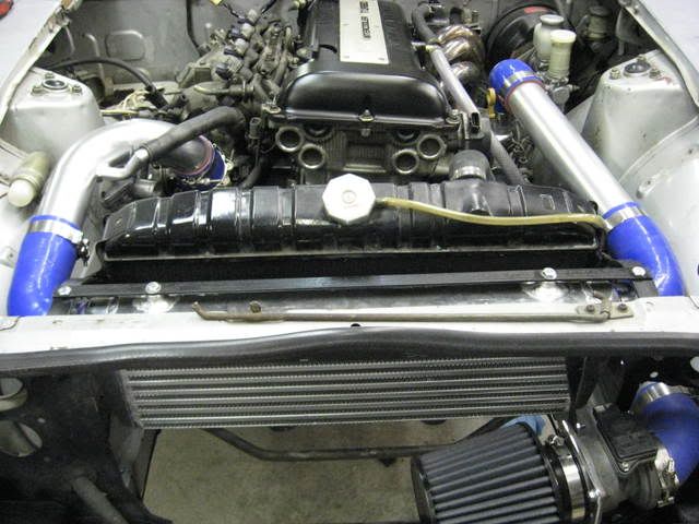

logr Posted February 1, 2009 Author Share Posted February 1, 2009 LSD is in, fuel system is done, engine is in, rad is in, intercooler is mounted, wiring is still to come. I was able to use the stock Z oil sending unit and hope the SR temp sending unit will work. Used stock fuel sender. Hoping to use all the stock guages except tach. We will see if I make it to the winter heat but I'm trying. Quote Link to comment Share on other sites More sharing options...

logr Posted February 7, 2009 Author Share Posted February 7, 2009 Down to wiring, exhaust and throttle cable. By angling the radiator, I was able to use a Z top hose and an SR lower. The bottom of the radiator is just behind the sway bar with enough room to enlarge the bar. I will make a plate for the top of the intercooler to seal the air going to the radiator. Doing things this way ended up with 2 straight pipes for the intercooler. The other one could have been a straight piece, a 45 silicone and a 45 metal. Iam somewhat hesitant about the air cleaner being in front though. It seems that rain could be a problem. Any ideas? I am thinking of making a front cover for it to keep the rain from hitting it full force. Quote Link to comment Share on other sites More sharing options...

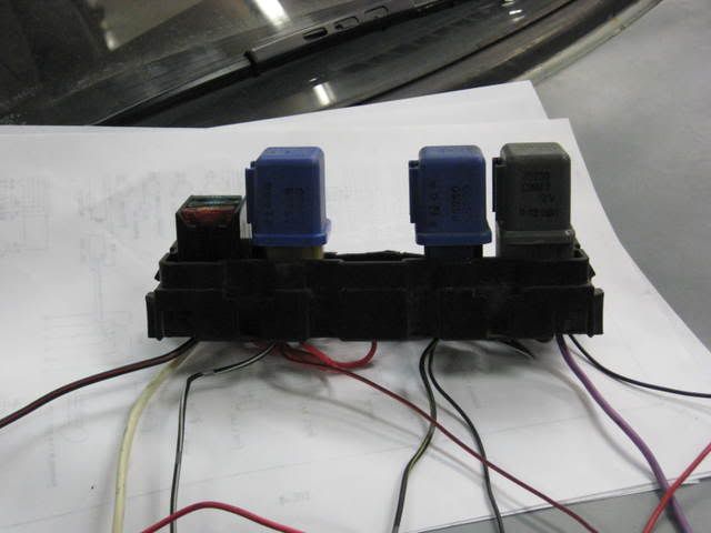

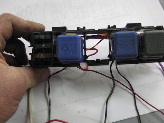

logr Posted February 10, 2009 Author Share Posted February 10, 2009 She runs!!!!! That is always a good feeling. You need 3 relays to make them run and I was going to use bosch type but I figured out something else, SX to the rescue again. The SX fuse box is modular. I took one apart and used one half. I moved a 3 fuse box into it as well as 3 relays. I then had a neat little package that can be mounted anywhere and it uses Nissan fuses and relays. The fuses are on the left, kind of hard to see. The throttle was very easy. KADE throttle cable bolted in the firewall and cut the end off the SX pedal top and weld on the Z. Quote Link to comment Share on other sites More sharing options...
