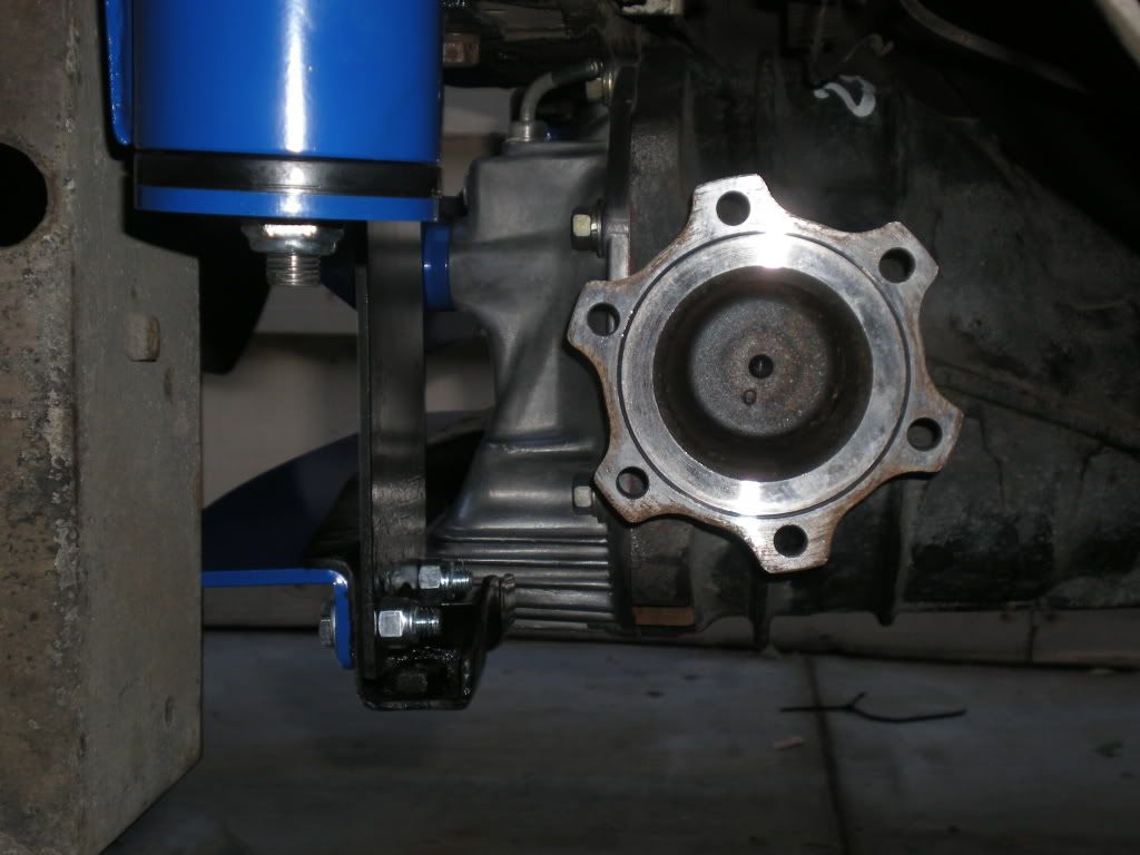

timbo1jz Posted October 29, 2008 Share Posted October 29, 2008 Got the Infinity Q45 R200 installed into my 74' on the weekend. I used Modern Motorsports mount kit and it is awesome! The fitment is perfect and the kit is heavy duty, very nice. Just working on the axels now. Here is a couple pics- Quote Link to comment Share on other sites More sharing options...
EvilC Posted October 29, 2008 Share Posted October 29, 2008 Looks good! Is it possible to get a shot of the diff from the front? Also is your diff pointed towards the pasn side of the trans tunnel? I am chasing vibrations issues in my car and I believe it has to do with the diff angle to the tranny and maybe the trans needs to be swung over to the drivers side tunnel a little more. Keep the pics coming! Clive Quote Link to comment Share on other sites More sharing options...
