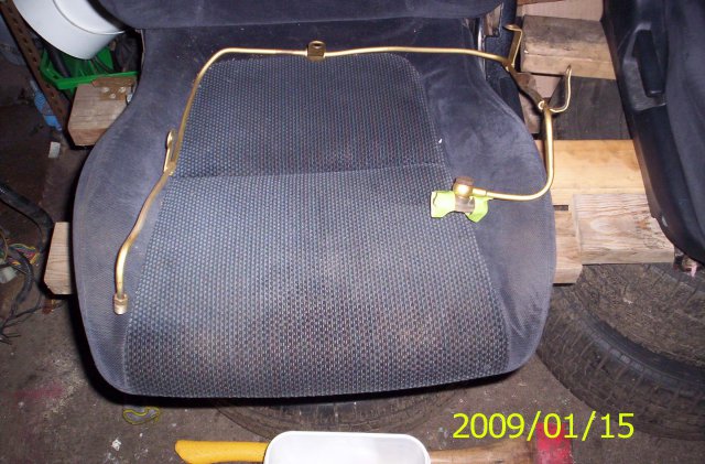

Noddle Posted January 13, 2009 Author Share Posted January 13, 2009 Thank you all, I have the banjo bolt and fitting, I'm planing to use some brake line to make this (from my wrecked MR30), one end has the flare , the other end will be silvered soldered onto the banjo fitting. I got my Tee now, went to the local hose fitting place, they had all the bits in stock to make it Nigel Quote Link to comment Share on other sites More sharing options...

Noddle Posted January 14, 2009 Author Share Posted January 14, 2009 islanddozer said: looks like you got what you need. good luck ! Thanks, I made this yesterday Nigel Quote Link to comment Share on other sites More sharing options...
islanddozer Posted January 16, 2009 Share Posted January 16, 2009 you might want to reconfigure your line. yours looks like it might be stcking out on the turbo end. here is a pic of the original Quote Link to comment Share on other sites More sharing options...
Noddle Posted January 17, 2009 Author Share Posted January 17, 2009 islanddozer said: you might want to reconfigure your line. yours looks like it might be stcking out on the turbo end. here is a pic of the original Thanks for that, If you look at these pictures, the turbo sits out a little further (1/2 inch spacer used), and I didn't want to try to bend the metal line to sharply (It was all bent by hand, no tool used except for the leg on the trampoline) also if you are wondering about the sump, it for my 240K, not 'Z', see pic. Nigel Quote Link to comment Share on other sites More sharing options...
