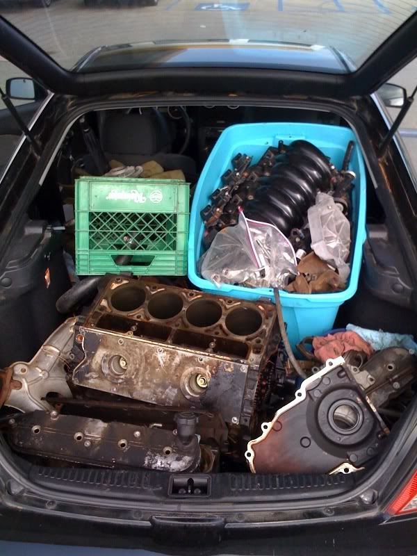

meindaparish Posted January 27, 2009 Share Posted January 27, 2009 Well, after a year of research and debate on which powertrain to swap into my n/a 2 seater Z32, I've finally decided to go with the lm7 5.3 liter small block chevy v8. I originally wanted the godly ls1, but since the lm7 only weighs about 60 or so lbs. more, i didn't think the ls1 was any longer worth it for my budget build, as i got the entire 40,000 mile engine, wiring, ecu, and accessories for $400. The next issue was finding a tranny that would break the bank or weigh as much as a beluga whale. For this I've drafted the assistance of a borg-warner T5 transmission. The bellhousing that is needed is an 11'' t5 chevy bellhousing. This tranny also helps offset the added weight of the lm7 over the ls1, since it weighs 50 lbs. less than the t56. So the project begins now, gentlemen. I'll keep updates as frequent as possible with as many pictures as i can take. If anyone has any questions or comments please ask, as i'm sure along the way I too will be asking many questions. Also, comments welcome! i picked up the engine yesterday, as well as my ls1 intake manifold. I also purchased the bellhousing i need last night, ill post pics of that later. Quote Link to comment Share on other sites More sharing options...

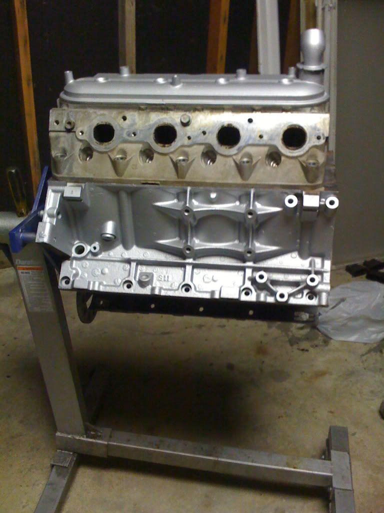

meindaparish Posted January 30, 2009 Author Share Posted January 30, 2009 Painted the block after getting it back from the hot tank. Also, cleaned the crap out of the heads and valve covers. The problem is I just found a ls1 longblock with a spun rod bearing for $350! So if the guy selling comes through, the title of this build thread may also need to change, but I'm not getting too excited yet. I really like the 5.3, but it would cost me more in new bearings, gaskets, seals, and labor to put it back together then it would cost to go pick up the ls1 longblock....it just seems to make sense. Quote Link to comment Share on other sites More sharing options...

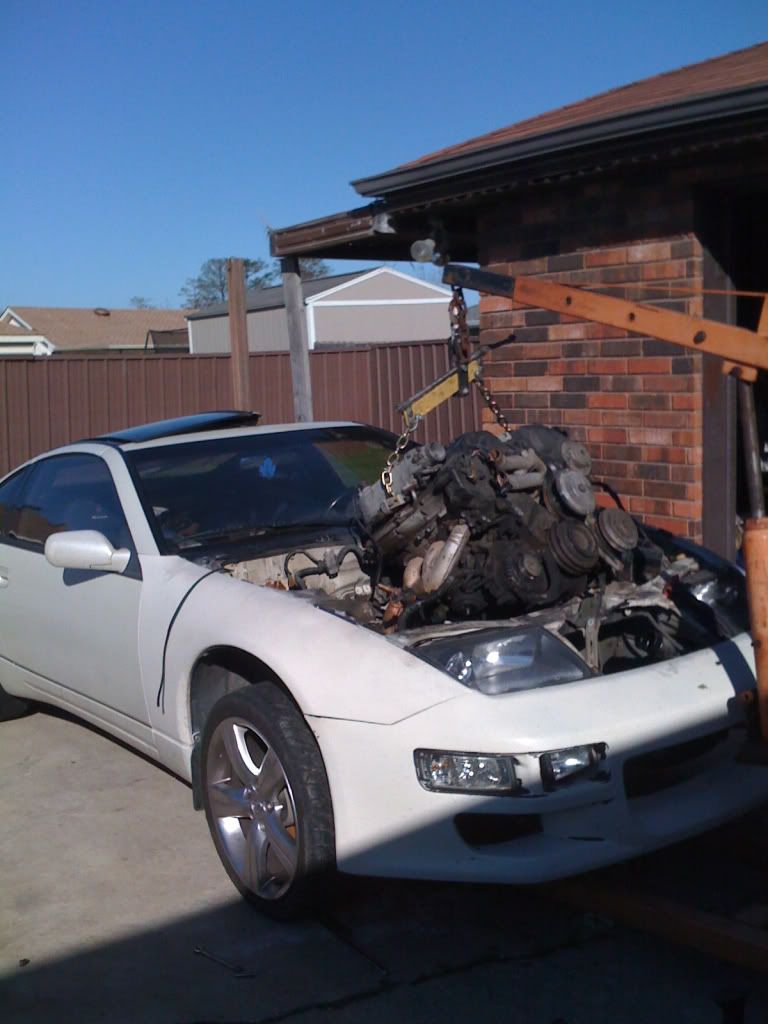

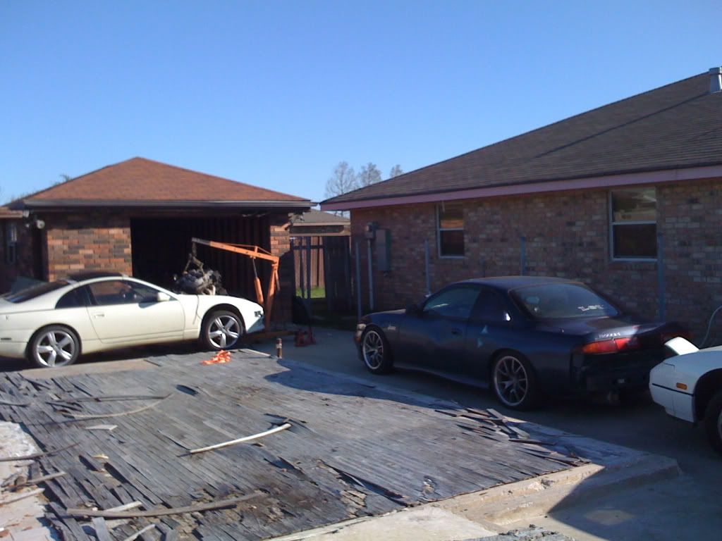

meindaparish Posted February 23, 2009 Author Share Posted February 23, 2009 UPDATE: I pulled that heavy ass vg30de out 2 days ago, heres pictures. Did it by my self, it SUCKED! My flooded, hurricane Katrina garage/driveway in which I am doing the swap. Quote Link to comment Share on other sites More sharing options...

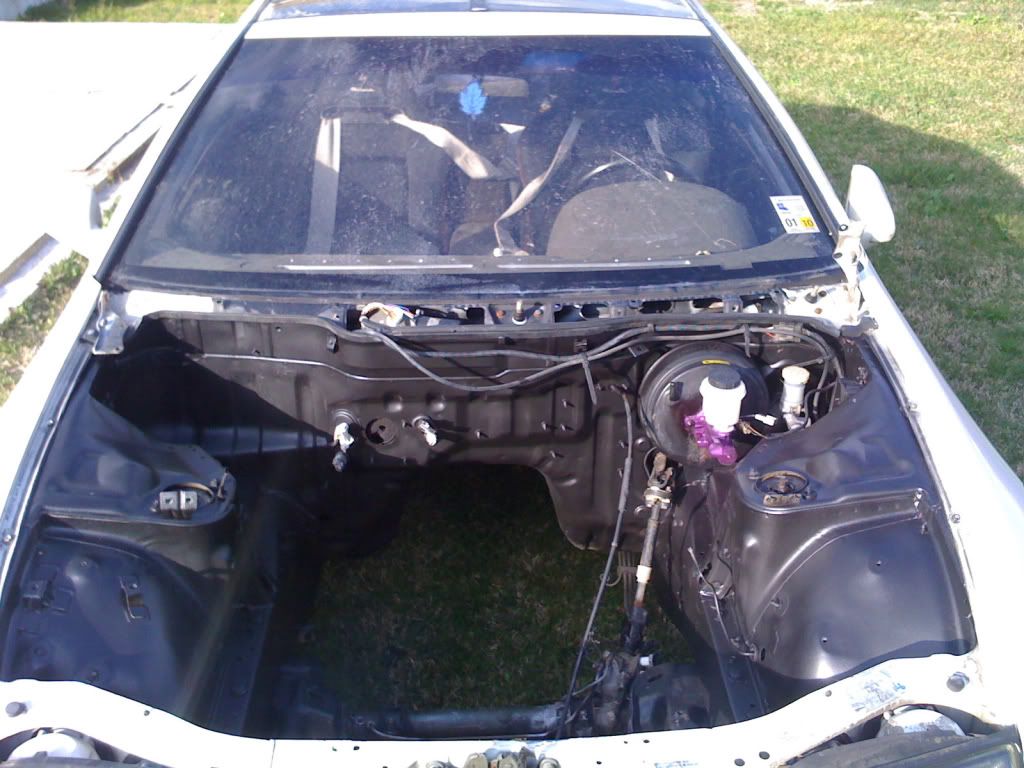

meindaparish Posted March 3, 2009 Author Share Posted March 3, 2009 UPDATE: Finally got the engine bay totally ready for the ls1. I found rust so it took longer than expected due to all the sandblasting and rust fixing that I had to do. heres a few pics of the engine bay all prepped and ready. [/url] Quote Link to comment Share on other sites More sharing options...

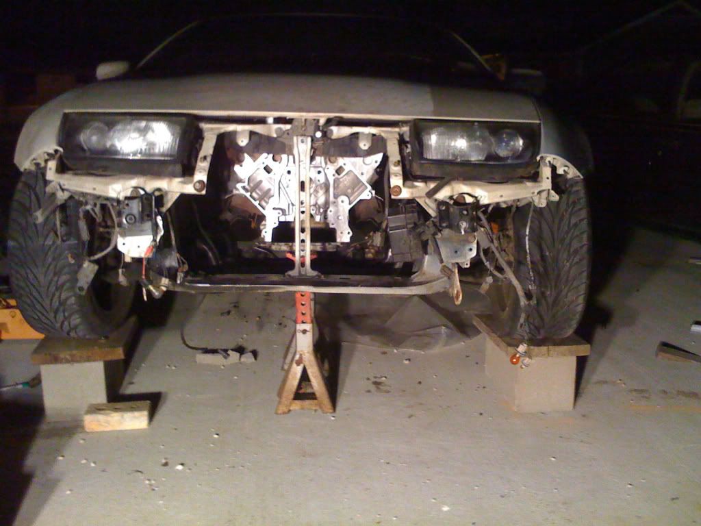

meindaparish Posted March 7, 2009 Author Share Posted March 7, 2009 Got my world class t5 today, 350 bucks. My cousin trying to check out some clearance. Late tonight I put my mock up, cracked ls1 block and extra heads together to start to mock up and fabricate my motor mount extensions. It looks like the truck motor mounts will work perfectly. Also, the F body exhaust manifolds clear the steering shaft BEAUTIFULLY. The whole package appears flawless, I must admit. Ill take a bunch of pics tomorrow in the daylight so everyone can see. I love progress. Quote Link to comment Share on other sites More sharing options...
