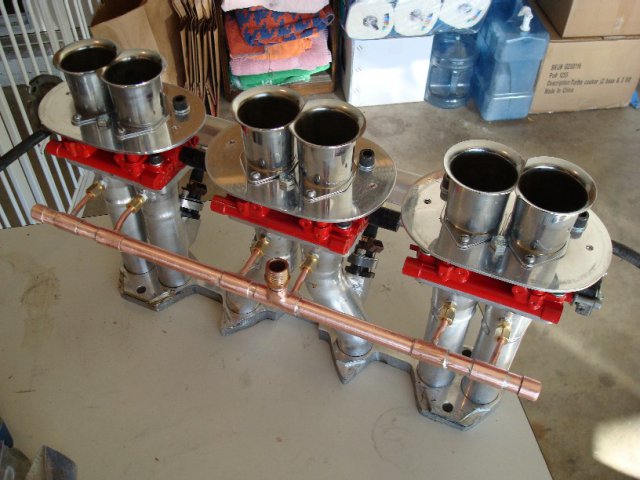

z-ya Posted January 30, 2009 Share Posted January 30, 2009 Do you a tube that connects all six intakes tubes together to one vacuum reference? I can't tell from your sig. Where do you have the brak booster connected, does it get vacuum from all cylinders? What is you idle vacuum (or kPa)? What cam are you running? Pete Quote Link to comment Share on other sites More sharing options...
SidWell Posted February 1, 2009 Author Share Posted February 1, 2009 Here is a pic of my balance tube. The ouput connects to my IAC, vacuum reservoir for the brake, A/C vent system, MAP sensor and vacuum for the fuel regulator. It idles at about 78 to 80 KPA. I cannot find the info on the cam. Quote Link to comment Share on other sites More sharing options...
Noddle Posted February 1, 2009 Share Posted February 1, 2009 Here is a pic of my balance tube. The ouput connects to my IAC, vacuum reservoir for the brake, A/C vent system, MAP sensor and vacuum for the fuel regulator. It idles at about 78 to 80 KPA. I cannot find the info on the cam. Did you use solider or silver solider to hold you balance tube together ? Nigel Quote Link to comment Share on other sites More sharing options...
z-ya Posted February 2, 2009 Share Posted February 2, 2009 You have plenty of vacuum. You don't need to use Alpha-N. Quote Link to comment Share on other sites More sharing options...
