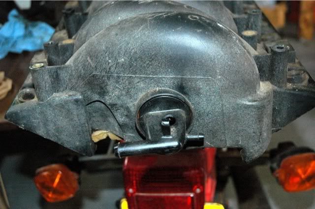

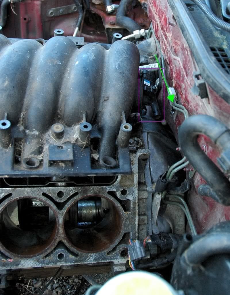

Administrators BRAAP Posted April 17, 2009 Author Administrators Share Posted April 17, 2009 (edited) Exactly! In moving the engine back 3”-3 ½” inches, you’ll solve lots of little issues, F-body shifter will exit in the stock location, etc etc etc… That McLeod Bell-housing should help tremendously in reducing the amount of cutting that will be required to the firewall/trans tunnel entrance. Something else that may help is the big vacuum port on the back of the LS1 intakes, (circled in MAGENTA) can be removed and that hole plugged which would eliminate the need to notch the firewall above the bell housing to clear that, (GREEN arrow)! You will need to find a vacuum source for the MAP sensor which is no biggee as there are 2 other vacuum ports, possibly three off the front and T/B combined. Worst case scenario, the big vacuum port goes to a vacuum reservoir. Something you will have deal with is the heater lines. Being as you are into the firewall and will have the dash out, this should not be a problem whatsoever. Just penetrate the firewall of the heater lines in location closer tot the passenger fender out of the way of the cylinder head. Making the decision to the cut the firewall is good one I that it makes this conversion SOOOOoooo much more realistic. I’m just not willing to do that with this particular car. Edited April 17, 2009 by BRAAP Quote Link to comment Share on other sites More sharing options...
Crash Posted April 17, 2009 Share Posted April 17, 2009 I thought about that vacuum line too. The thing is that I'm pretty sure that one goes to the brake booster. (I'll have to recheck) Notching the firewall to fit that line wouldn't be that big of a deal. As long as I'm already there, it shouldn't be too big of an issue. I saw another Z32 conversion where they had to cut in a small rectangular area to fit that line, but I can't recall what they said they were using it for. I imagine that if they kept it and went through all the work for it, it's likely important! LOL (Though, if I have any unused vacuum ports hanging around, I'd rather to that route. Worst case scenario, I can get an electric brake pump sold for electric cars to handle that.) I saw that the heater lines needed to be moved in the LT1 conversion on this forum too. I figured that wouldn't be a big deal at all. There's definitely a lot of room between the block and the firewall. I'm wondering what the consequences are of moving the block so far towards the firewall though? Heat? Quote Link to comment Share on other sites More sharing options...

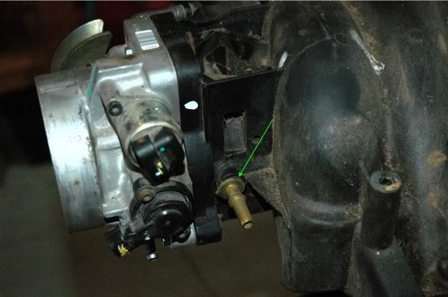

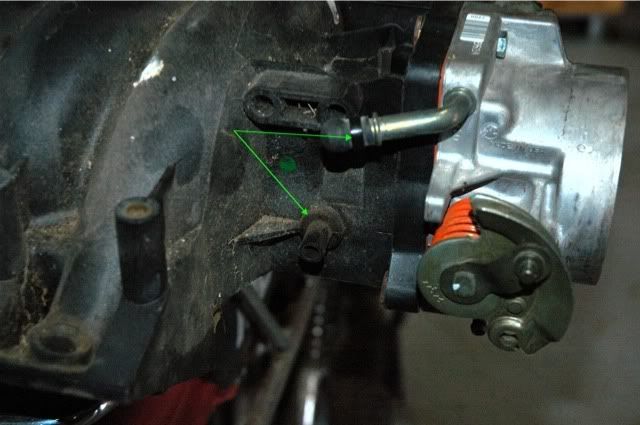

Administrators BRAAP Posted April 17, 2009 Author Administrators Share Posted April 17, 2009 Crash, Yeah that port is convenient for he brake booster, being right there and so close. Not sure if this helps, but here are a few shots of my mock up LS1 intake. My thinking is it might easier and less hassle to remove the vacuum port at the rear of the intake than I would be modify the firewall at that location and the goodies that lie on the other side of the firewall in that location. The rear. That plug assy does float in the back of the manifold. Feels as if it is sealed by O-ring and is either push locked or twit locked to the manifold. At some point I will look into this a little more and may try to remove one.; Here is the front of the manifold. One port on either side of the plenum entrance and one on the TB itself. Quote Link to comment Share on other sites More sharing options...
Crash Posted April 17, 2009 Share Posted April 17, 2009 Ah. Damn, I wish I had my Trans Am right now to see what those ports on the manifold went to. LOL I'll have to look at my friend's tonight to see what they go to. I know I can do a T splitter too as an option. I just wouldn't want that to affect the item it's already being used for. I think one goes to a sensor to tell the ECU to advance timing. The other I can't imagine where it'd go. EDIT: Yeah, you're right. Where that vacuum port sits on the back, there may be something I'm going to want behind the firewall. I'm going to find that other page I saw the cut made and see what they removed. Quote Link to comment Share on other sites More sharing options...
