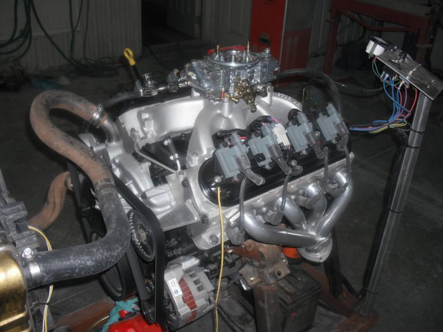

scott sharp Posted June 15, 2009 Author Share Posted June 15, 2009 this is a pic of the engine on the stand i built to run it on to work out any bugs Quote Link to comment Share on other sites More sharing options...

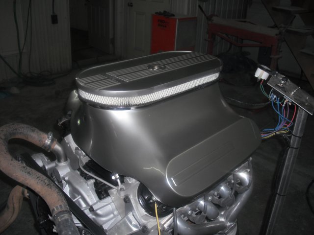

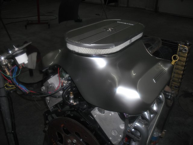

scott sharp Posted June 15, 2009 Author Share Posted June 15, 2009 here are some pics of the engine cover and breather I still have to do some more painting on them yet but you will get a idea what it will look like. Quote Link to comment Share on other sites More sharing options...
