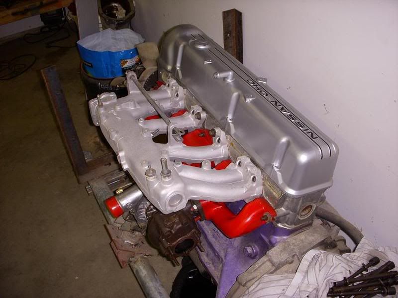

zbigtim Posted February 22, 2009 Share Posted February 22, 2009 After collecting parts all winter and just got my P90 back from the machine shop, I was mocking up my intake, exhaust, and turbo this weekend. Running into a couple of problems. One: I believe the PCV valve is going to be in the way of the compressor housing, depending on how I clock the housing. Two: I was wanting to use the stock wastegate actuator for now, but don't have any good ideas on how to mount it on the larger T4 compressor housing. I want to thank all the guys here on the Hybrid Z site for all of there hard work and sharing there of. This site is truly awesome, and I would not be to this stage without it. Any ideas with these problems (which I think are minor) would be appreciated. Thank you in advance! Quote Link to comment Share on other sites More sharing options...

zbigtim Posted February 26, 2009 Author Share Posted February 26, 2009 Thanks for the replys, guys. I will be getting the stuff to tap and relocate the PCV, probably in the heat shield boss like aarang suggested. Pyro, that is a very interesting idea on running the intercooler piping under the pan. But for right now the budget does not allow an intercooler. Maybe later this summer. I will definitely keep this in mind. I was able to trim the mouning bracket on the WG actuator and get it mounted tonight. I will post pictures later. Quote Link to comment Share on other sites More sharing options...
