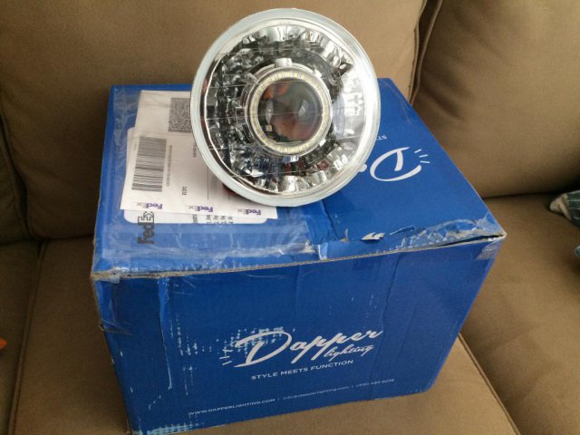

Savage42 Posted June 26, 2015 Share Posted June 26, 2015 Well, you just have to love getting new parts at your front door. I'm not usually the kind of person to get excited about anything that doesn't make my car faster or handle better, but after seeing the Dapper Lights in person and thinking about the long, dark 2-lane roads to and from Sebring, I thought some good lighting is in order. (for safety and they look cool) Time to wire them up and finish the body harness and go have some fun. Getting close!! Quote Link to comment Share on other sites More sharing options...

Savage42 Posted July 27, 2015 Share Posted July 27, 2015 The install process of the Dapper Lighting units was pretty quick and easy. I plan to have the halo rings come on when I have the parking lights on, as I don't care to have them on all the time. (just me) I have yet to wire them up, as I am currently going through the entire body harness and adding that wiring inside the harness to make it look OEM. I have to say that they certainly give a more modern look to our classic Z cars. Nice quality, for sure. Quote Link to comment Share on other sites More sharing options...

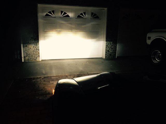

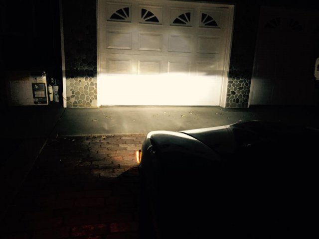

Phantom Posted September 19, 2015 Share Posted September 19, 2015 Here are some night time shots of the Dapper Lighting HID headlights. The low beams have a nice clean cut line and visibility with both the low and high beams is far superior to the OEM headlights. Low Beam: High Beam: Quote Link to comment Share on other sites More sharing options...
